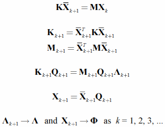

The basic equations of the Bathe subspace iteration method are, see Ref. [2]
As discussed in Refs. [1] and [2], the method combines inverse iterations on a subspace – hence the name 'subspace iteration method' – with Rayleigh-Ritz analysis to extract the best eigenvalues and eigenvectors from each subspace. The key is to establish a 'good' and adequate set of starting iteration vectors. The solution procedure can also be accelerated through shifting.

In this News we focus on another important item, namely the use of parallel processing in the Bathe subspace iteration method. Considering the basic equations given above, it can be seen that the method entails an initial LDLT factorization of the K-matrix, and then forward-reductions and back-substitutions of many iteration vectors. While the factorization of the coefficient matrix can be performed to some extent in SMP and DMP, i.e. shared and distributed parallel-processing, the forward reduction and back-substitution of the iteration vectors particularly lends itself to parallelization because each vector is calculated independently from all others. Hence, blocks of vectors can be assigned to different nodes of a machine and can be processed simultaneously.
ADINA offers SMP and DMP for the Bathe subspace iteration method and the method can be used in linear and nonlinear analyses including large deformations and contact.
