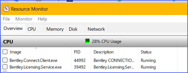

ii. After signing into Connection Client, right mouse click on Windows Start and select Run, enter "resmon", click OK, Confirm both applications are listed and status = Running:

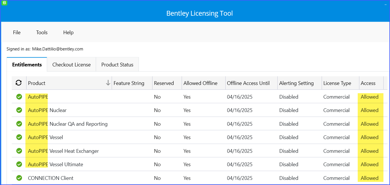

14. Open BLT (Bentley Licensing Tool)
Verify user is Logged in, after starting BLT, look above the Entitlement tab on the dialog, is the user's email address displayed?
If No, go back to Step #13 above.
If Yes, continue below
a. Go to the "Tools" pulldown and choose "Send Logs Now".
b. Go to the "Tools" pulldown and choose "Refresh Policy".
c. Go to the "Tools" pulldown and choose "Reset Policy".
Grab bottom right corner of the BLT application, left mouse click, hold, and drag dialog to the right until horizontal scroll bar disappears.
Questions:

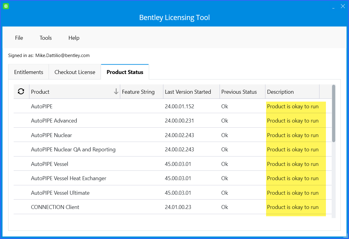

> On the Entitlements tab, scroll down so AutoPIPE related items are visible, does all of AutoPIPE's related items appear with access column = Allowed?
> On the Product Status tab, scroll down so AutoPIPE related items are visible, are all the AutoPIPE products listed with description = Product OK to run"?
If No to any of these questions,
1. Go to the "Tools" pulldown and choose "Activation wizard" command, follow prompts to activate AutoPIPE
2. Next, try to Use AutoPIPE, select License available to you (if unknown, contact Bentley On-Site Admin for assistance).
Review Entitlements and Product status again, have the AutoPIPE related products updated to the correct settings mentioned above?

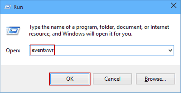

19. Open Event Viewer application and clear the logs.
a. Press Windows+R to open the Run dialog, enter eventvwr (or eventvwr.msc) and hit OK.
b. In the window that appears, expand Windows Logs on the left sidebar, and right mouse click on Application select. Then select Clear Log option. After the dialog opens press the Clear button to clear the log file. Repeat right click and clear process on the remaining icons - Security, Setup, System, and Forward Events.
