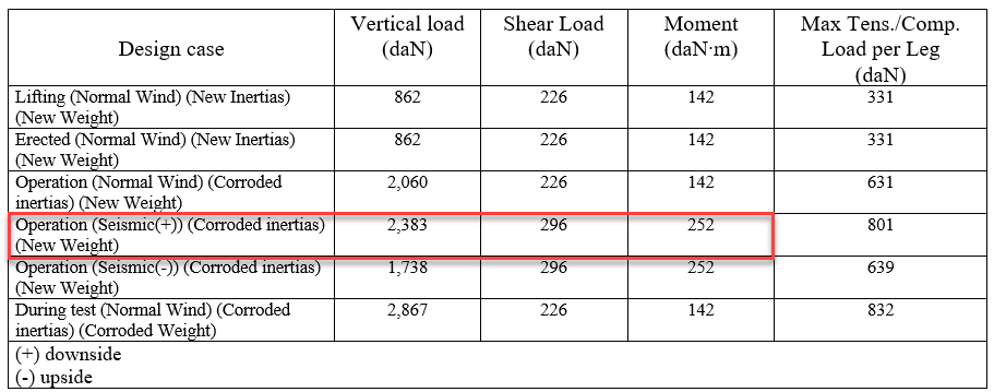

Loads reported in foundation summary are correct. It is normal to have the vertical loads higher than shear loads and moments..
Understand the basis of foundation load calculations,

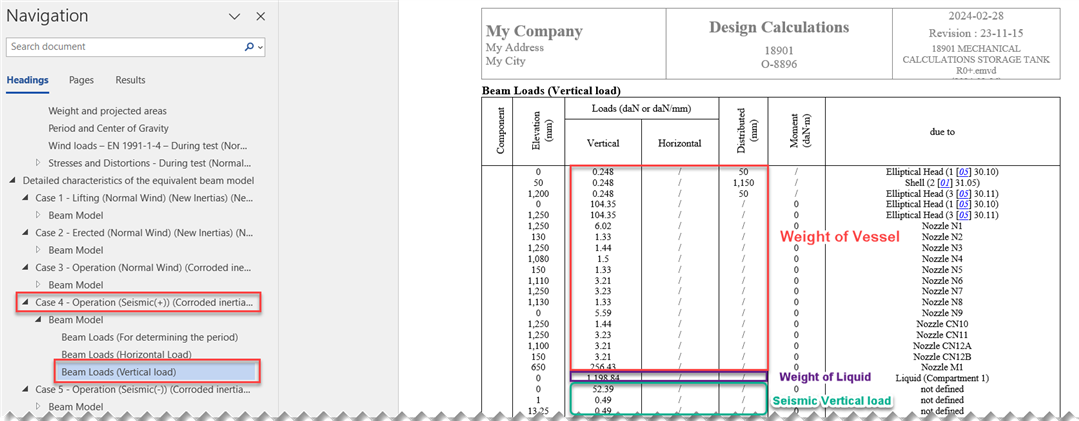

Vertical Loads = Weight of vessel with liquid + Seismic vertical load + weight of support
Vertical Loads = 2010 + 323 + 50
Vertical Loads = 2383 daN (Matching with the report).

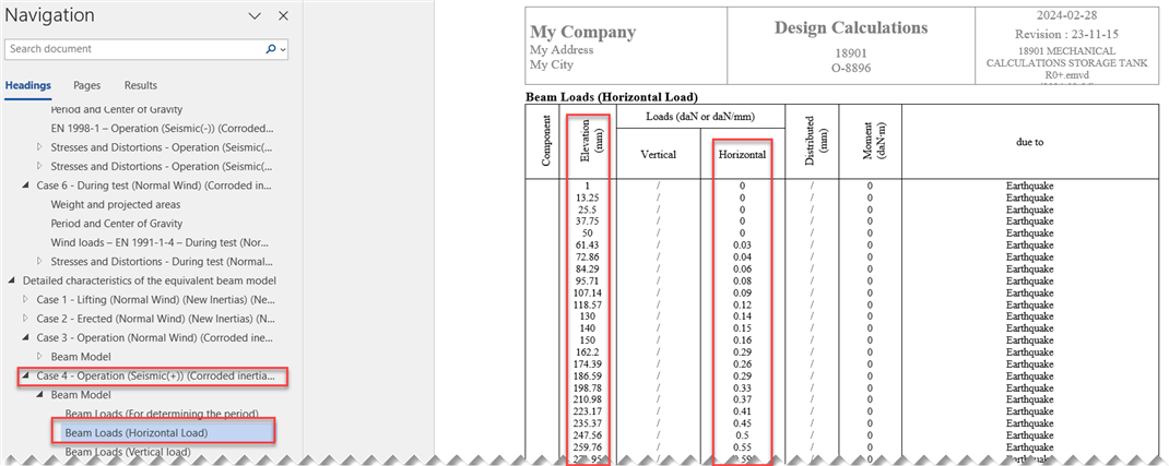

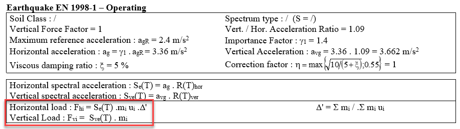

See below formulae for Horizontal and Vertical Seismic Loads,

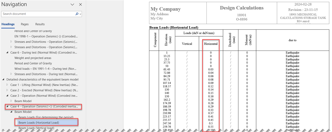

Horizontal loads are being calculated at different elevations, see below snap
Sum of all horizontal seismic loads = 296.2 daN (Matching with the report).
Moment = Shear Load x Moment Arm (Elevation of Load acting)
Calculate the moments at every elevations.
Sum of all calculated moment = 252 daN.m (Matching with the report).
