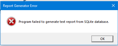

When generating a complete model input listing, the following was displayed:
Report Generator Error
Program failed to generate text report from SQLite database.
OK
Why?
