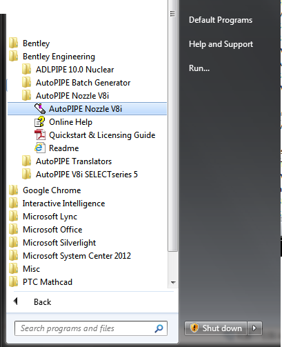

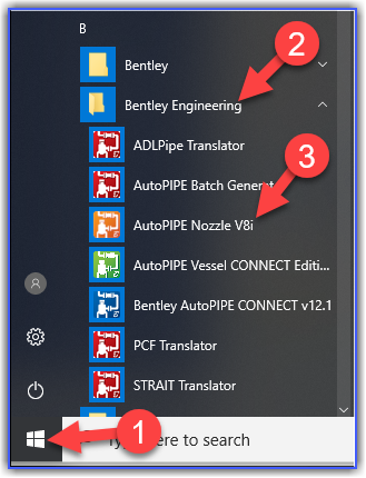

Item #3: How to install AutoPIPE Nozzle 08.11.08.xx and higher if the installation option to install was unchecked during installation of AutoPIPE V8i?
Answer:
Uninstall AutoPIPE, and re-install AutoPIPE V8i confirming AutoPIPE Nozzle option is checked ON as shown above.
After the installation is complete,  verify it has been installed by selecting Start> All Programs> Bentley Engineering> AutoPIPE Nozzle icon should now be listed, start the program as desired.
