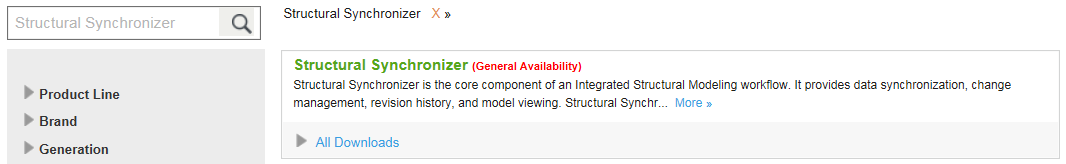

Structural Synchronizer can be downloaded from Bentley’s i-ware site here.
Structural Synchronizer can also be downloaded from Bentley Cloud Services. After signing into the CONNECTION Center, select Software Downloads under My Support. Once on the Software Fulfillment page, the Structural Synchronizer installer can be located by performing a search on “Structural Synchronizer”.

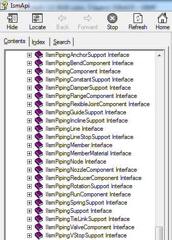

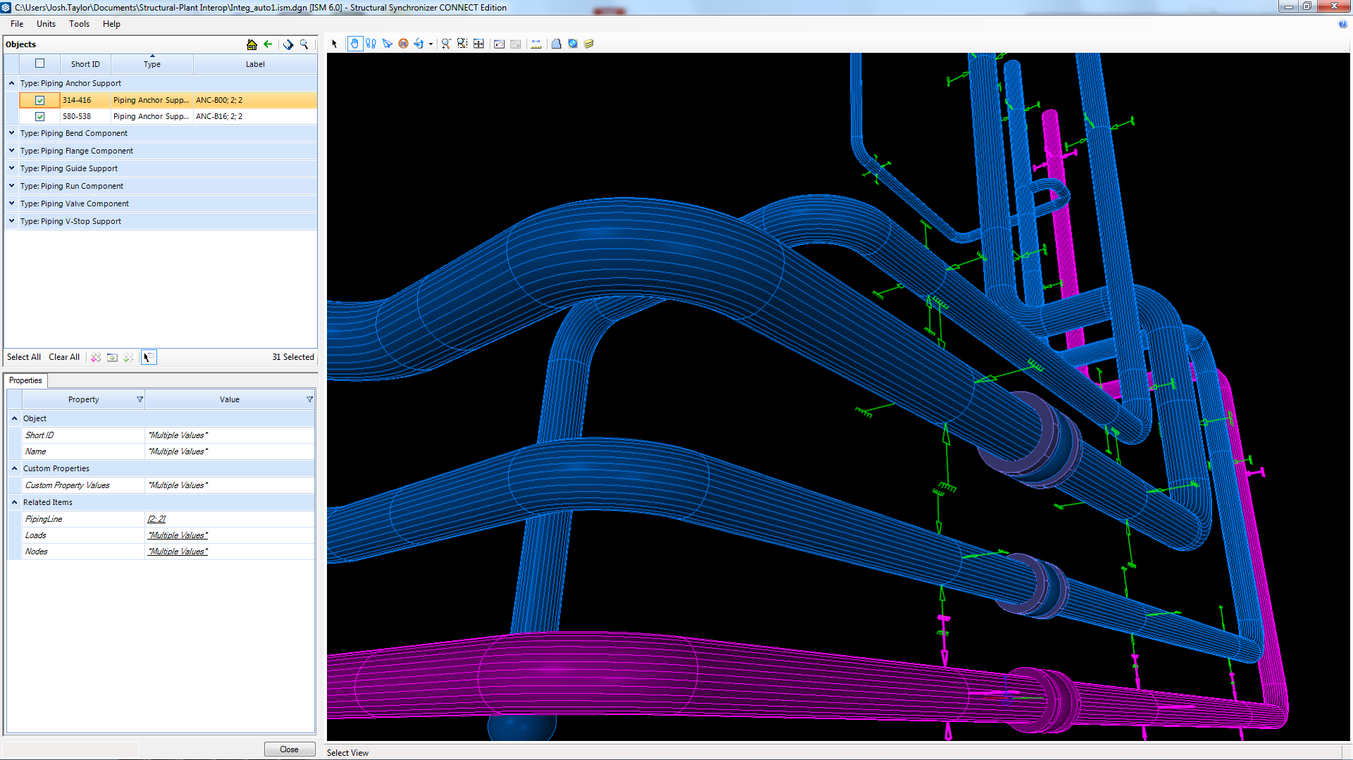

Piping Systems
This release incorporates piping systems into the ISM framework. Piping, bends, flanges, valves, pipe supports, pipelines, and piping reactions can now be written to and read from an ISM model with the ISM 6.0 API. Likewise, Structural Synchronizer now supports visualization and revision management for piping. The ability to now combine piping systems with structural elements in one ISM repository provides a robust framework for plant design workflows.
The ISM SDK documentation has been updated with piping interfaces new in 6.0. Coding samples are also now available that demonstrate how to build a structure using the ISM API. For more information on the ISM SDK, please contact Josh Taylor at Josh.Taylor@bentley.com.

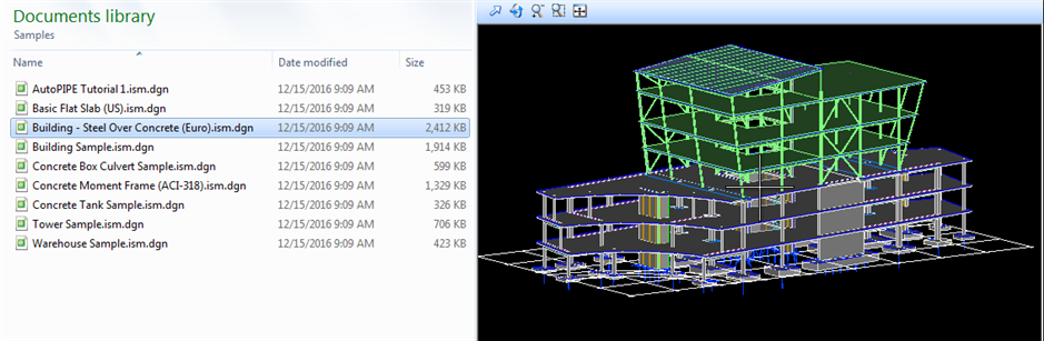

New Sample Models
New sample repositories are delivered with the installation of Structural Synchronizer. These sample repositories are located in the following folder:
\Documents\ISM\Samples
The repository AutoPIPE Tutorial 1.ism.dgn was published from AutoPIPE using the tech preview interoperability with ISM. Basic Flat Slab (US).ism.dgn was published from RAM Concept. The repositories Building - Steel Over Concrete (Euro).ism.dgn and Concrete Moment Frame (ACI-318).ism.dgn were published from RAM Structural System. The beam, column, and wall reinforcing were designed in RAM Concrete.
