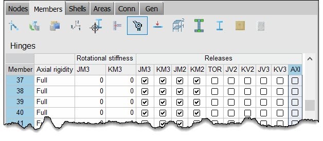

Member Fixity
Indicates the Hinges assigned to the ends of each member in RAM Elements.

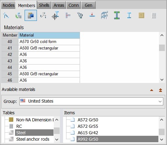

Material
Indicates the name of the Material assigned to each member in RAM Elements.

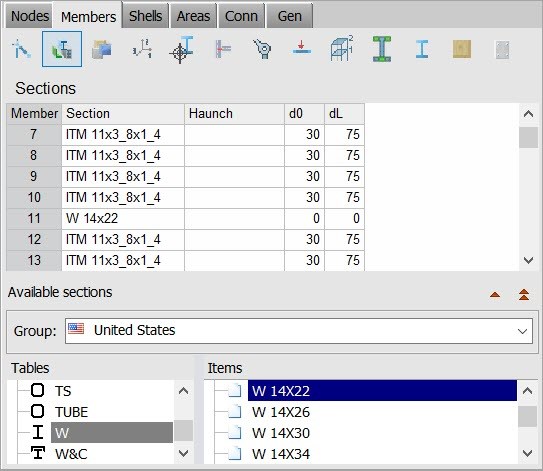

Section
Indicates the name of the Section assigned to each member in RAM Elements.

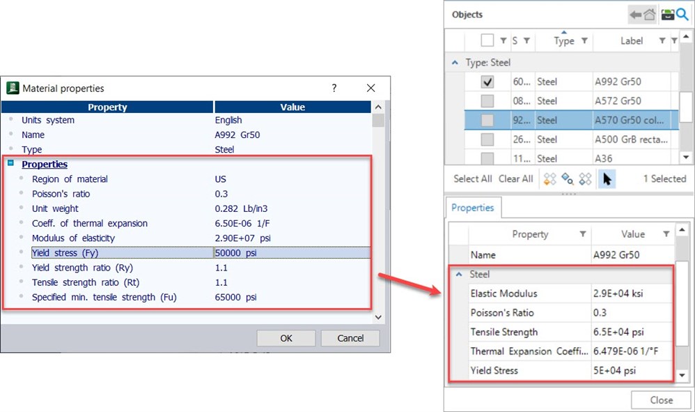

Material Properties
In RAM Elements, material properties are assigned to each member using the Materials Database. The steel material properties from the database are pushed to the iTwin Analytical Synchronizer as Steel objects.

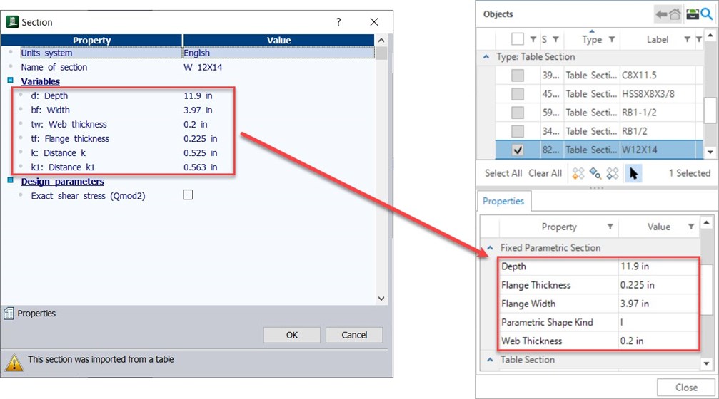

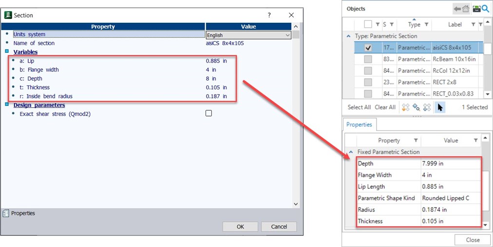

Section Properties
In RAM Elements, section properties are assigned to each member using the Sections Database. Standard steel sections are pushed to the iTwin Analytical Synchronizer as Table Section objects.
All other sections are pushed to the iTwin Analytical Synchronizer as Parametric Section objects.
