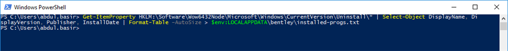

Application crashes - List of installed programs and components
a. Go to start and type ‘Powershell’
b. Copy/Paste the following command into the powershell window:
X86 Programs
Get-ItemProperty HKLM:\Software\Wow6432Node\Microsoft\Windows\CurrentVersion\Uninstall\* | Select-Object DisplayName, DisplayVersion, Publisher, InstallDate | Sort-Object DisplayName | Format-Table –AutoSize > $env:LOCALAPPDATA\bentley\installed-progs-x86.txt
X64-Programs
Get-ItemProperty HKLM:\Software\Microsoft\Windows\CurrentVersion\Uninstall\* | Select-Object DisplayName, DisplayVersion, Publisher, InstallDate | Sort-Object DisplayName | Format-Table –AutoSize > $env:LOCALAPPDATA\bentley\installed-progs-x64.txt

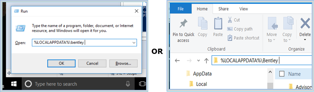

d.  Open folder location:
- %LOCALAPPDATA%\Bentley
or
- C:\Users\username\AppData\Local\Bentley
e. Find and Send 'installed-pogs.txt' file for review

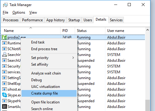

Application crashes - Program Dump
a. Start Task Manager by right clicking the taskbar and selecting 'Task Manager'
b. Go to “Details” tab and find “prodia2.exe” in the list (the AutoPIPE Vessel program GUI).

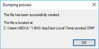

c. Right click and select 'Create dump file'

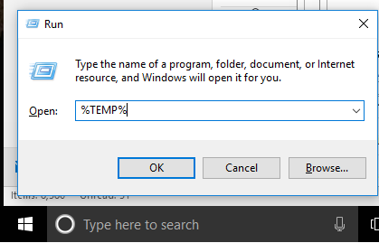

d. The file will go to your temp directory with name ‘prodia2.dmp’
e. Open folder location by typing '%temp%' in run or File Explorer
f. Find and Send 'prodia2.dmp’ for review.
