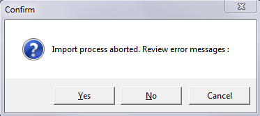

When importing an AutoPIPE NTL file from the PCF translator the following appears:
Confirm
 Import process aborted. Review error messages :
Yes   No   Cancel
What should I do?
Answer:
There are literally a 100's of different reasons that would cause this message to appear. The only way to know for sure what the problem is, is to select "Yes" and read the error message report. Consider the following procedure:
Aborted issues
    1. When the message above appears, select the "Yes" button.

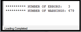

    3. Scroll down to the bottom of the listing to see the number of errors:
    4. In order to open the model in AutoPIPE, only the ERROR issues need to be resolved. Therefore search the entire report for these Error locations and information about the errors:

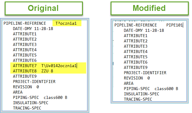

5. Strange text characters
Please, notice the line Pipe line reference name, ATTRIBUTE7, and ATTRIBUTE8 - as they contain unsanctioned characters.
Remove / Replace characters as needed.

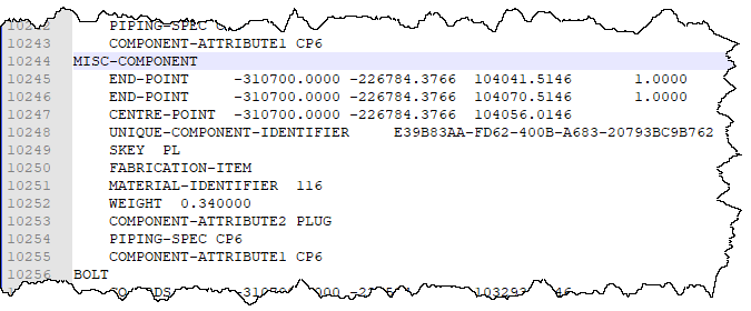

6. Non-component name being used
See the image below on line 10244
This name is not apart of the PCFin.map file and therefore is not mapped to any component known in AutoPIPE. Thus the program fails / aborts. Simply rename " MISC-COMPONENT" to "Pipe" or delete the entire card from the file. After making the changes to all such occurrence in the file, save and try to import the file again using the PCF translator.
