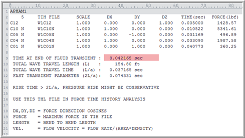

Item #2:
On step 3, where does 0.0425 secs come from?
Answer:

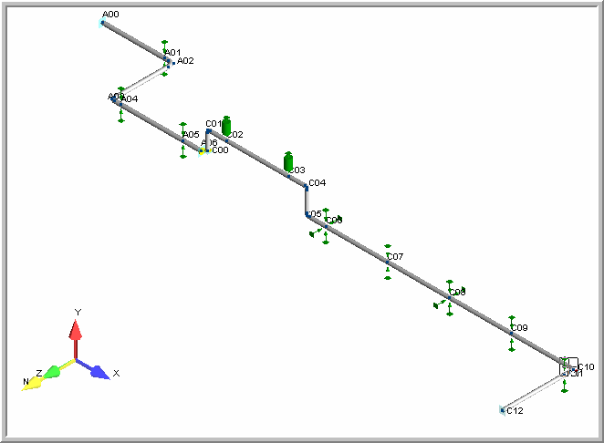

A valve at the end of the discharge line is closed suddenly which creates a pressure shock wave traveling at the speed of sound back down the line. A similar shock wave is assumed to travel down the suction line.
Executing Water Hammer Example (apham1)

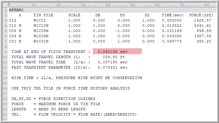

3. Create a Water hammer load case W2 for the suction line from point A06 to A00 as shown below.
Note, 0.0425 sec is the Start time of the 2nd shock wave upstream of the pump. Another words the first shock wave ends and the 2nd one begins, See "W1.THL" file
 The equation to calculate this value is mentioned in the same step of this example, refer to the step in the example for details.

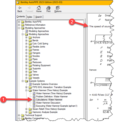

Item #7:
The calculation for speed of sound for fluid appears to be wrong.
Answer:
See AutoPIPE help ribbon> Contents> Contents Tab> Modeling Approaches> Example Systems>
The most import issue is that you use the correct values and all of the conversion factors:
Due to unit conversion add in the following factors appropriately = 144 in^2/Ft^2, and 32.2 Ft / sec^2.
Speed of sound in a fluid for this example should calculate out to 4163 ft / sec (same as mentioned in help example).
