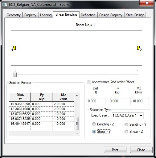

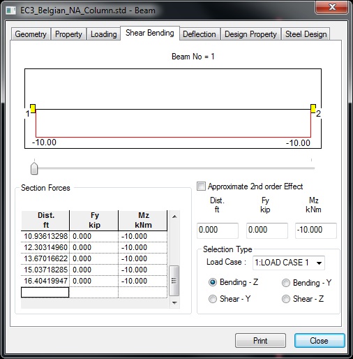

A European I section cantilever beam (HD320X127, S275 grade steel) , 5 m has been subjected to a concentrated point Load of 25 KN (FY) and concentrated moments 5 KN-m (MX) and 10 KN-m (MZ) at the free end.
 Outputs: MA= 10 KN-m, MB= 10 KN-m, SFA= 0 KN, SFB= 0 KN

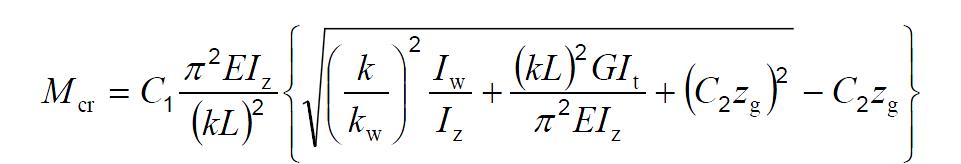

Moment Capacity, Mckd = Wply*fy/GM0 = 2149*1000*275/ (1*10^6) = 590.975 KN-m
STAAD.Pro value is 591 KN-m [OK]
Here, CMM=2.0, CMN=0.7
So, C1 = 2.578, C2 = 1.554

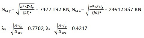

Π2*E*Iy/ (kL)2 = 7477192.555
(k/kw)2 * (Iw/Iy) = 22394.19851
(kL) 2 *G*It/( Π2*E*Iy) = 23736.5416
C2Zg = 1.554*160 =248.64
So, Mcr = 1540.6 KN-m
STAAD.Pro value is 1541.5 KN-m [OK]

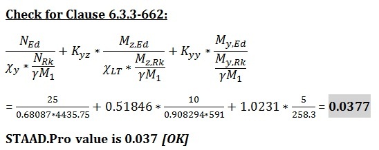

NEd = 25 KN,                                                                      NRk = A*fy = 4435.75 KN
My­Ed = 5 KN-m,               MzEd = 10 KN-m,             MyRk = 258.3 KN-m

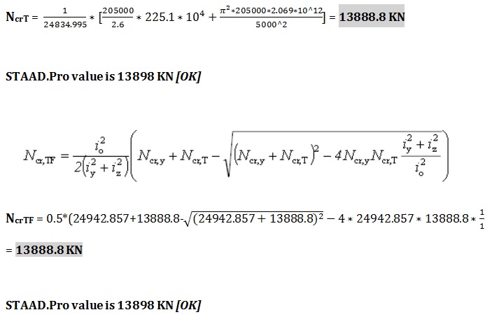

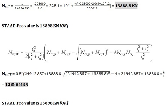

Critical Axial Loads for Flexural and Flexural Torsional Buckling:
From NCCI document SN001a-EN-FU:
Here, y0 = z0 = 0
iy = 75.68 mm, iz = 138.23 mm
So, i02 = 75.682 + 138.232 = 24834.995

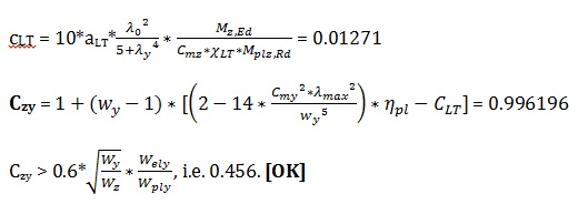

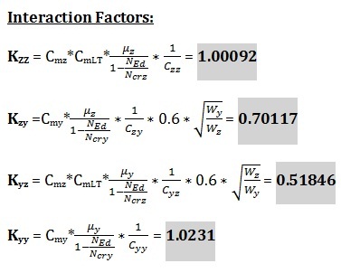

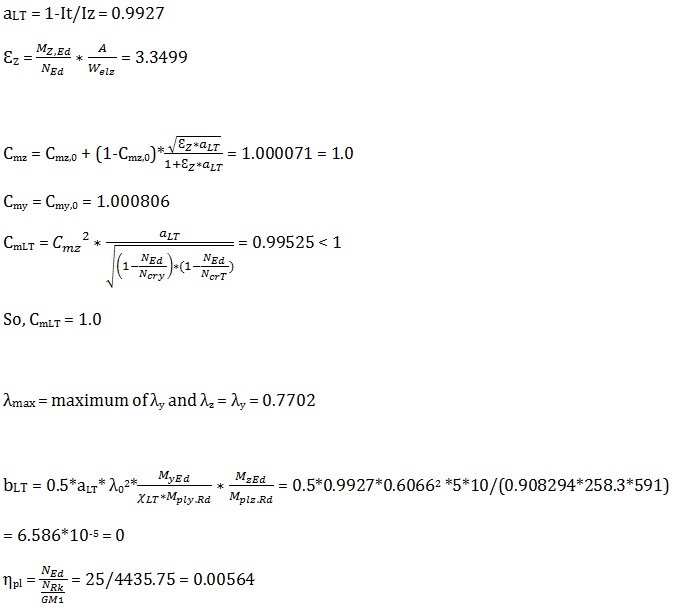

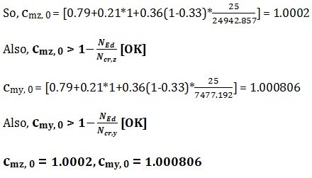

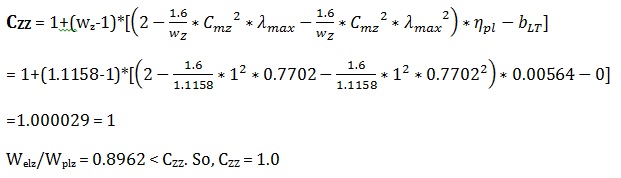

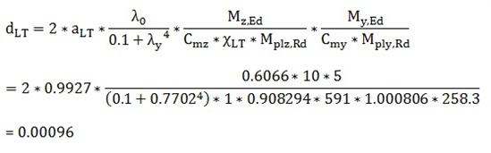

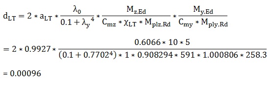

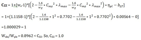

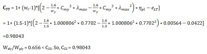

Interaction Check:
From Annex A, Table A.1 of EC3, we get the auxiliary terms:
χLT = 0.908294
 Wz = wplz/welz = 2149/1926 = 1.1158
Wy = wply/wely = 939/615.933 = 1.525 > 1.5, so, wy = 1.5
 CMM = 2.0, ψ=1.0

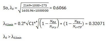

Determination of λ0:
C1=1, C2=0
Mcr = 1605.96 KN

NcrTKN1389813888.8
NcrTFKN1389813888.8

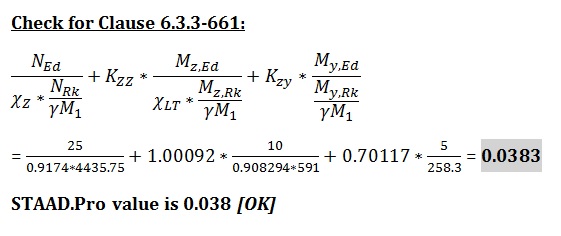

Cl. 6.3.3-661-0.0380.0383
Cl. 6.3.3-662-0.0370.0377
