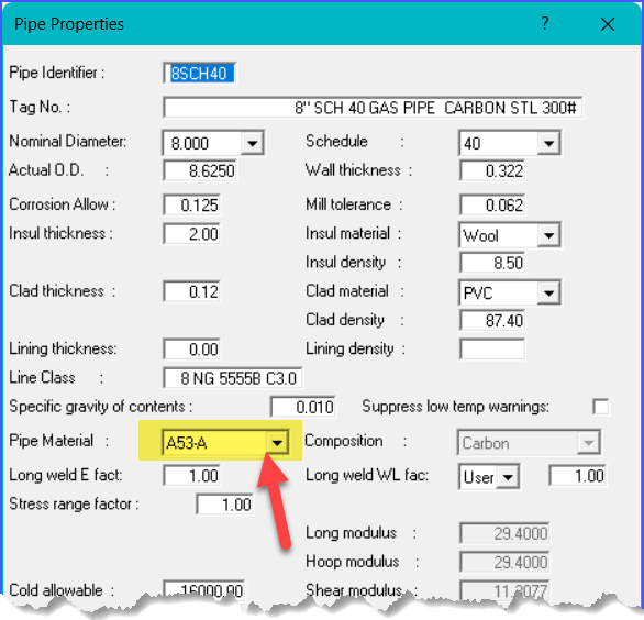

01c. i. Add New Material to Existing Library, for use on Pipe Properties, AutoPIPE v.9 and higher
Product(s): AutoPIPE
Version(s): All
Area: Library
Dec 2014, AutoPIPE V8i 09.06.01.10
How to add a new material to existing library, for use on AutoPIPE's Pipe Properties dialog?
AutoPIPE V8i v.9.0 and higher

Step 1: Identify material data needed, folder location for the new material
Data Needed:
With a model opened in AutoPIPE, open the General> Model Options> dialog
Next, select the Tools > Library Editor command> select File> Open> (locate the default material library mentioned above), select Open button. In the top left corner of the screen set, Table = (select drop down and choose the 1st option), when the screen refreshes, take a screen shot. Repeat this process for each of the table options. This represents the data and units of values needed for adding the new material.
Note: All AutoPIPE material libraries are in English units and are converted to other units using the Units file conversion factor.
Folder Location:
Start AutoPIPE
Go to Tools> Settings> Preferences> record the Program Data Path (ex. C:\ProgramData\Bentley\AutoPIPE 2024\)

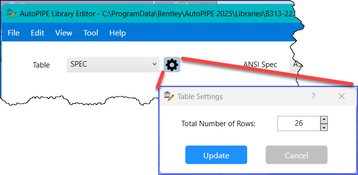

Option #1: Use AutoPIPE's Library editor
AutoPIPE 12.05 and higher has a new tool called Library editor. Use this tool when adding / modifying a material library file.
Learn to use the Library editor with 30 min on demand video here.
Notes:
  1. The table length (number of rows) for an entire library must be the same for each type of table (ex. SPEC, MATL).
    1. Example, Open B313-22 src file in the library editor, select the MATL table and Material ID = CS, notice the number of temperatures equals 14, but the total number of row that can be entered is 74. Therefore all of the different material IDs for this library must have 74 rows. Conversely, select Table = SPEC, for each ANSI Spec material name the total number of rows allowed to be entered is 26.
    2. Modify the total table length by selecting the cog wheel to the right of the Table selection. Enter the total number of rows or use the arrows to adjust the number, and select Update button when done.
    3. ***Important***  due to material library memory buffer limits of 231 (calculated by (No. of rows) x (No. of columns)), the table length should only be as long as required by the material with the most data inputs. Any material data added to the table beyond this buffer size can be entered, but will be ignored by the program or no data returned when called for. Please vote in favor of this IDEA here to automatically limit the number of rows that can be added to a material's table.
