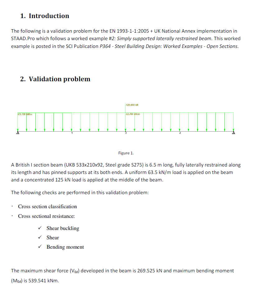

Example 2 verification as per SCI P364 (EN 1993-1-1:2005)
  Product(s): STAAD.Pro
  Version(s): All
  Environment:  N/A
  Area:  Steel Design
  Subarea:  Verifications
  Original Author: Modestas Turulis
A validation PDF document and STAAD.Pro model can be downloaded from Attachments section on the top right.
