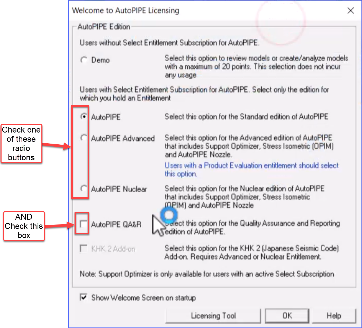

5. Start AutoPIPE and set Licensing options
After starting AutoPIPE QA verson 23 or higher, the "Welcome to AutoPIPE Licensing" dialog should appear as shown below (if not, from the landing page select License> Configuration command). at which point the user should enable radio buttons for an editions of AutoPIPE (ex. Standard, Advanced, or Nuclear) and enable check box in front of "AutoPIPE QA"
Note: Users who are not connected to the license service will need to check out both a. AutoPIPE Edition and b. AutoPIPE QA&R entitlements.

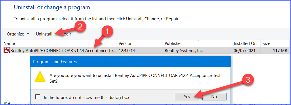

7. How to Uninstall an AutoPIPE ATS?
Conduct an online search to find instructions on how to uninstall applications from a particular Operating System
Example: Windows 10
After the application has been uninstalled, locate and manually remove the ATS installation folder as mentioned in readme file / release notes.
