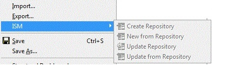

The ISM section in Staad is grayed out

When I am trying to run the ISM section in Staad, the option to create the repository is grayed out.
Explanation:
There could be two reasons behind it,
Please note that Structural Synchronizer is the engine that makes ISM work.

2) If you have already installed Structural Synchronizer and the ISM part is greyed out, then there may be a version mismatch between STAAD.Pro and Structural Synchronizer.
Uninstall Structural Synchronizer from the machine. If you have the installation package for STAAD.Pro, extract the files and look for StrucLinkForStaadProSetup******_SS*.msi file and install it.

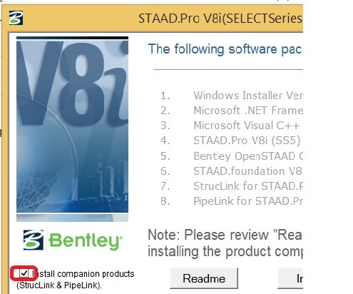

If you do not have the STAAD.Pro installation file, please download it from the Fulfillment Center .
Once, you have downloaded the file, while installing it, if you check the box where it says install Companion Products, then Structural Synchronizer will be installed along with StructLink & PipeLink.
If you do not want to install StructLink & PipeLink, then you will have to extract the files and install StrucLinkForStaadProSetup******_SS*.msi file from the list of files.
