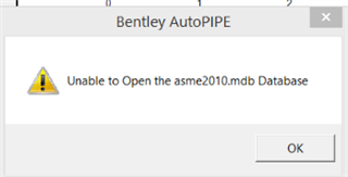

The following warning is displayed when using AutoPIPE:
Unable to open the asme2010.mdb database
OK
Why and How to avoid it?

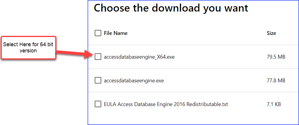

Solution #3: Using Office x64 and update Database engine
Answer these 2 questions
1. Does the computer have Microsoft Word and Access x64 bit installed?
Watch video below to see what office version is currently being used.
2. Is "Microsoft Access Database Engine" installed?
Note: most MDB issues are often caused by this tool
If no to either question above, uninstall the existing "Microsoft Access database engine" application using Windows "Add and Remove Programs" application, use link here to download a 32 bit version of this application, and install the newly downloaded application. Next, reboot your computer and try to use AutoPIPE.
If yes to both question, continue below
Note, just to be safe, recommend uninstalling, downloading, and reinstalling "Microsoft Access database engine" from here.

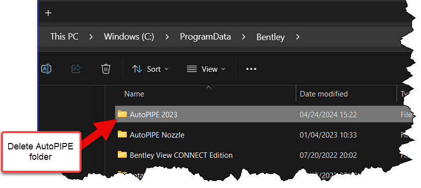

Solution #7: Correctly install AutoPIPE
During installation some files were not installed correctly. Therefore, follow these steps below:
1. Close all but one instance of AutoPIPE before before continuing below.
2. Open Preferences dialog - click here.
3. Click on each Explorer button to open their folder locations in different File Explorer windows.
4. Next, close the current AutoPIPE application.
5. At this point, all AutoPIPE applications should be closed and 2 Windows of File Explorer are opened
6. Go to each File Explorer window (User Profile path and Program Data path) that was opened from step above, and delete AutoPIPE folder
Example:
7. Next, Use standard Windows procedure for uninstalling applications, Uninstall AutoPIPE.
8. Reboot the computer.
