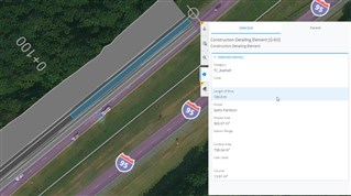

After slice, new child element has calculated area, volume and few properties copied from parent element. Slice by edge, Slice horizontally tools additionally create property 'Length of slice'. To review all parent's properties for selected child element, select 'Parent' tab in Properties widget.
Selected child element's properties:
Properties for parent element:

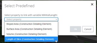

Slice by edge, Slice horizontally tools create property 'Length of slice'. When needed this property could be used to calculate quantity.
