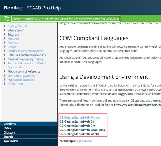

Query: How to use OpenSTAAD in other programming languages?
Response:
- After opening STAAD.Pro application, click on Help and then click on Contents.
- Please refer to the below location in STAAD.Pro Help
Home > OpenSTAAD > OS. Writing OpenSTAAD in Other Programming Languages
- In this section, separate links are available for different programming languages.
- In these links, the detailed description is provided on how to use OpenSTAAD using different programming languages. You can follow the steps mentioned in the link and can use OpenSTAAD functions
