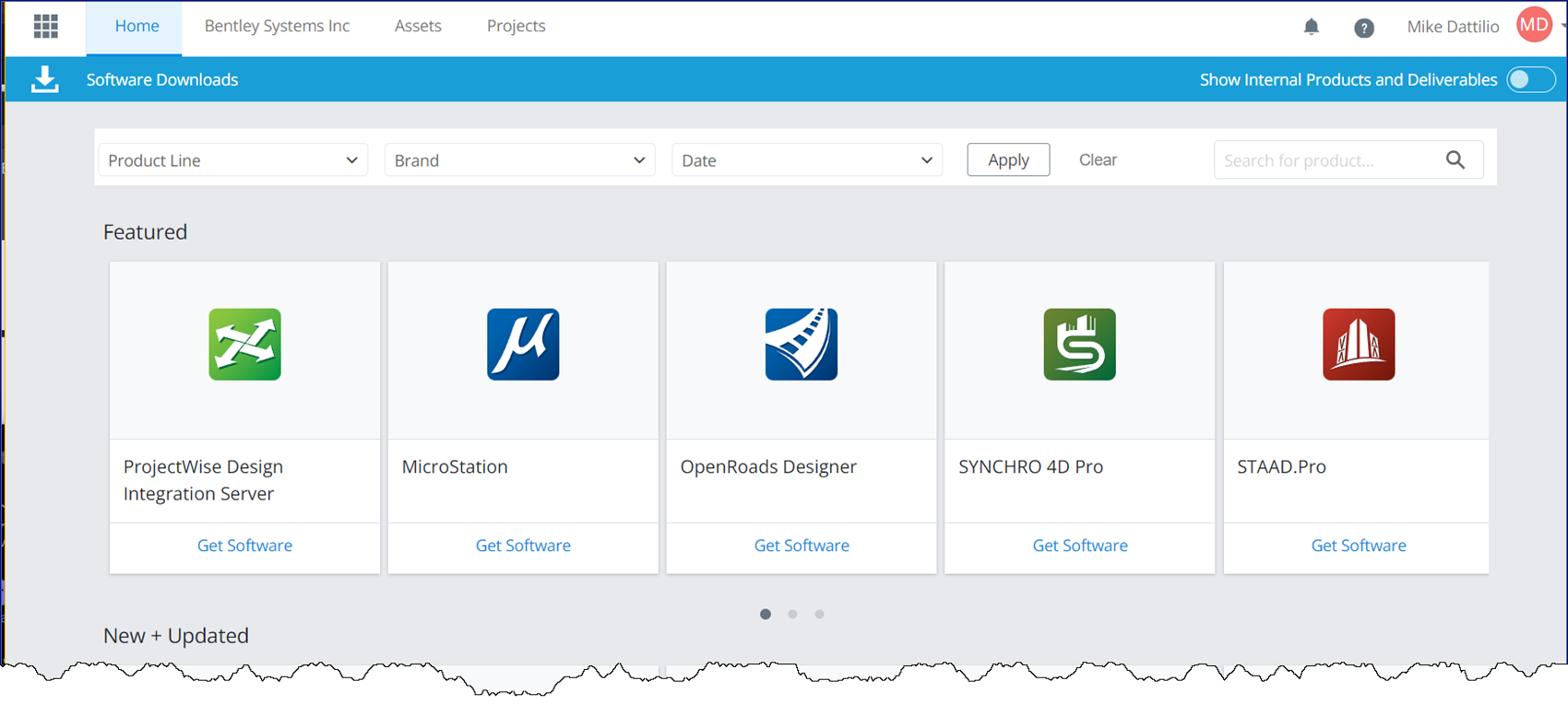

Step #1: Access Software Download using 2 different methods
1. Bentley CONNECTION Client
or
2. Bentley CONNECTION Center

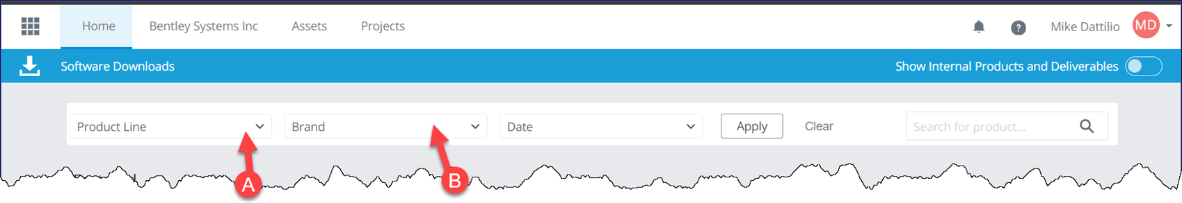

Step #2: After Software Download is opened, filter from all available software to AutoPIPE products only
Select the following settings:
a. Product Line =  Pipe Stresses and Vessel Analysis
b. Brand = AutoPIPE or AutoPIPE Vessel
c. Press Apply button

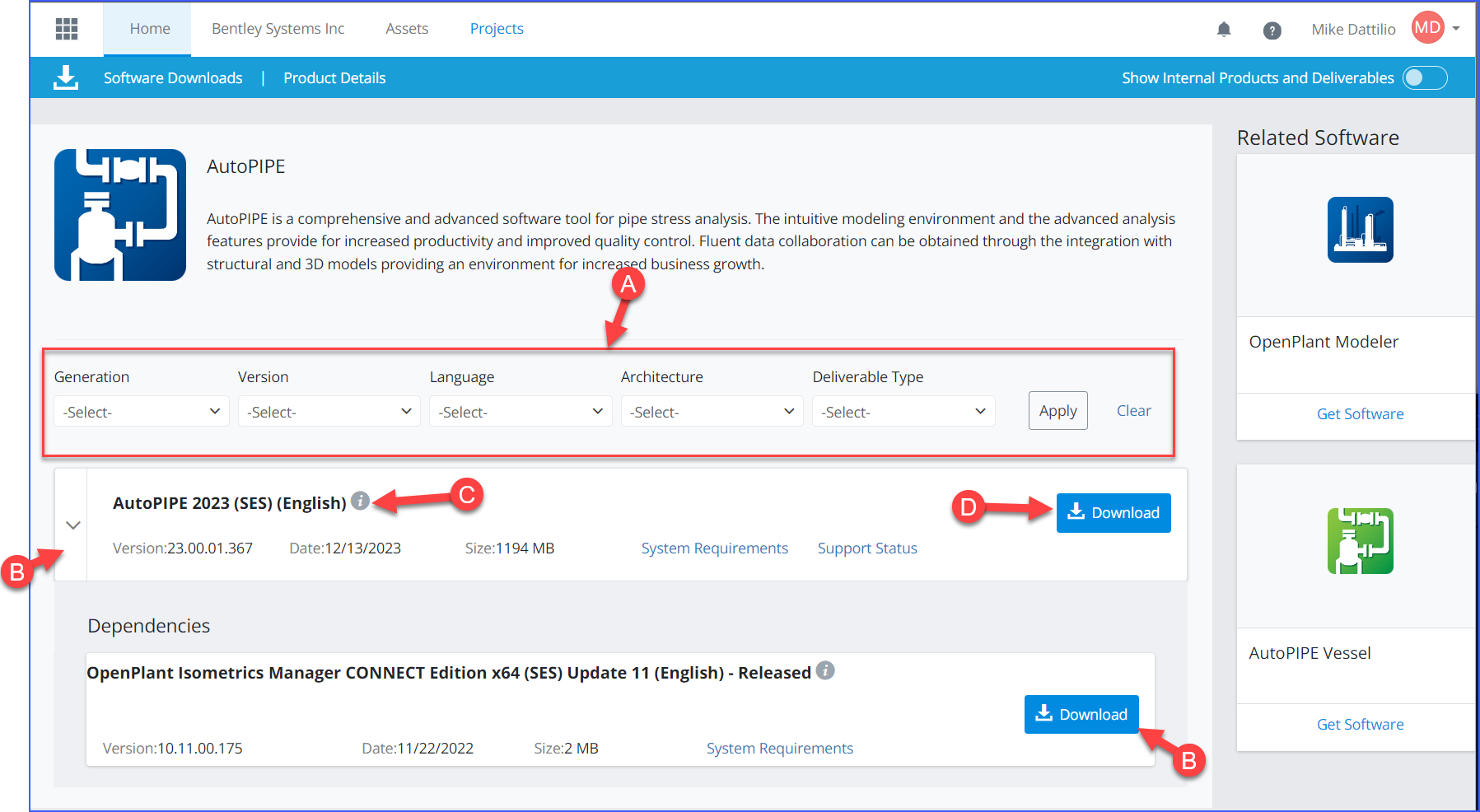

Step #3: Choose a tile (AutoPIPE)
AutoPIPE is available in 4 different versions (i.e. Standard, Advances, Nuclear, and QA&R) and 1 add-on (KHK2 Add-on). These versions and add-on are controlled by the licensing inside of the application. Therefore, only need to download one edition of the software, always select the first tile labeled AutoPIPE. Again, all the feature are installed, the license selection from with in the application controls the feature availability with in the application.
Question: Can I download AutoPIPE's full ATS program?
For AutoPIPE Vessel, again, all features are installed during the installation, and the selected License inside of the application controls what features are available within the application.

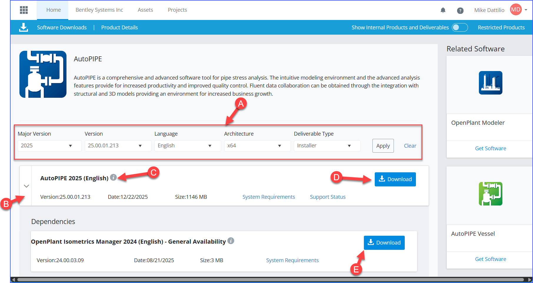

Step #4: Filter, Dependencies, Read-me file, and Download
Note: Current version = AutoPIPE 26.00.00.306 (release notes and readme files)
A. Filter - Suggest to press the Clear button on the far right, and then press Apply button to see all of the versions available.
Next, make changes to the drop-down filters as needed to be applied to the list of available software
Question: The version I need is not listed here, What are my options?
B. Dependencies - pressing the carrot at the start of a line will display a list of dependencies available for that software. These are separate downloads and separate installation procedures that are performed after installing AutoPIPE.
Question: Do I need to download these dependencies?

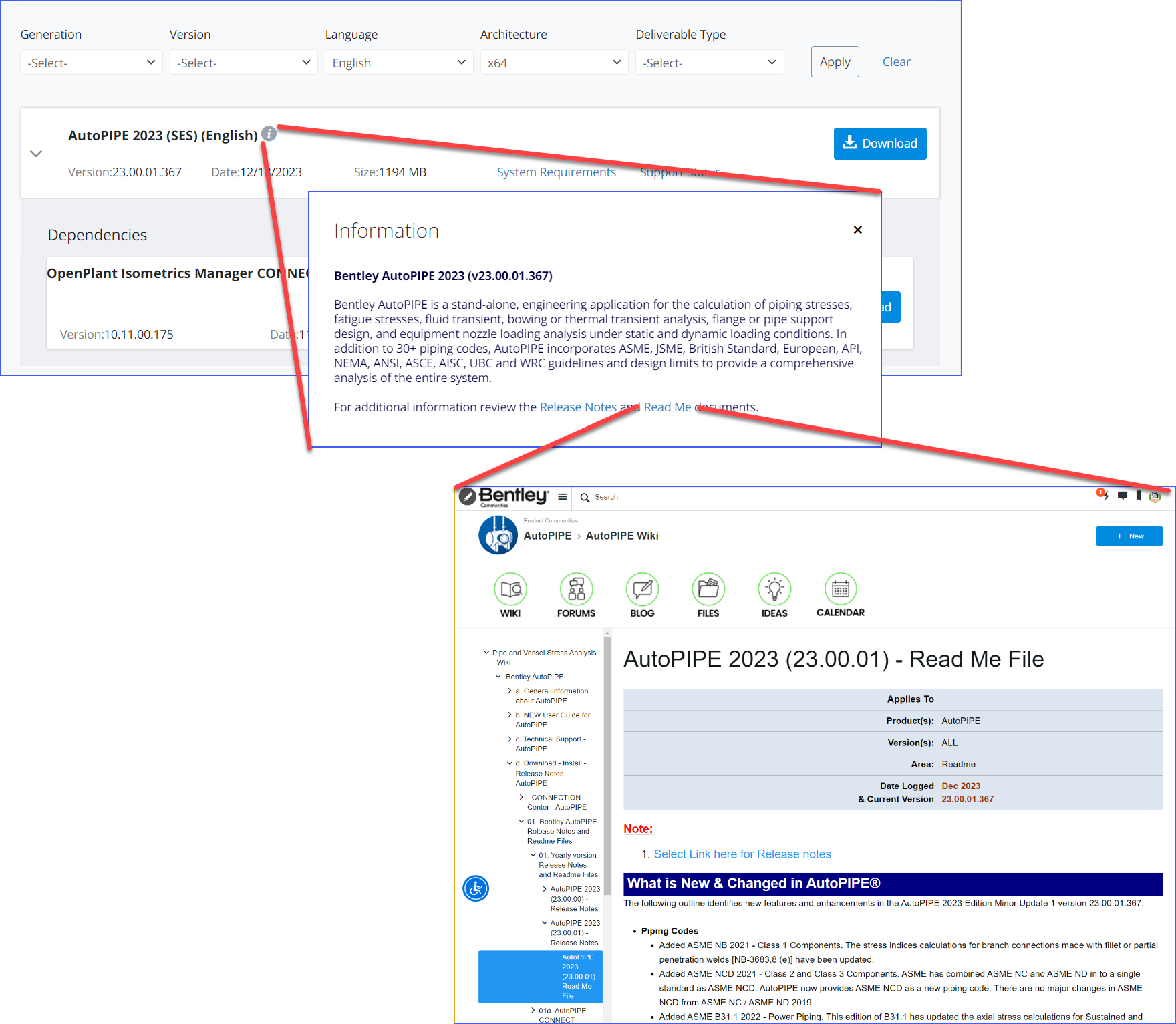

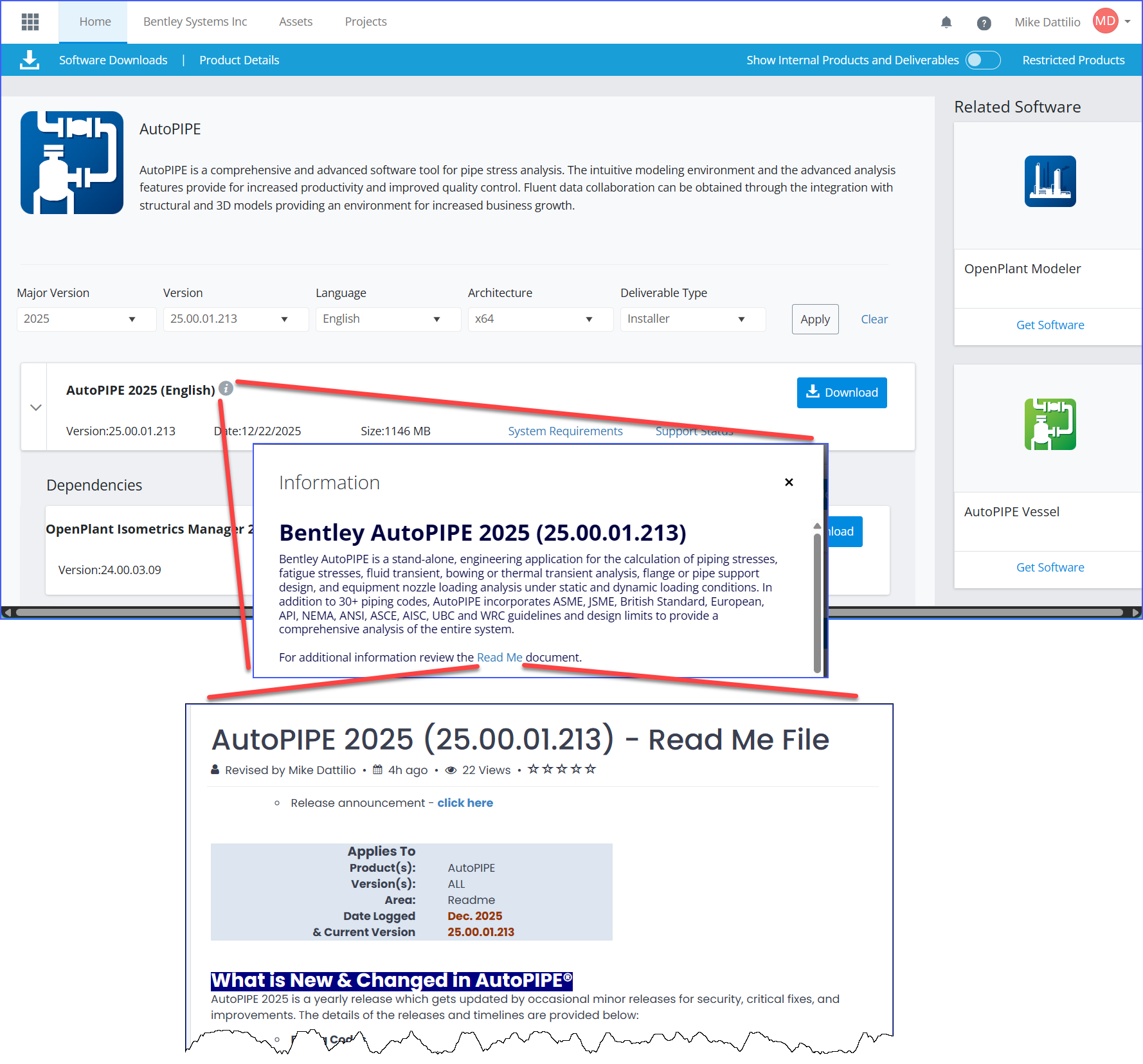

C. Details and Readme - pressing the "i" balloon will open a dialog that indicates additional details. These details contain a link to the respective Readme file on Bentley Communities
D. Download button - press the download button to download the respective line item. Be sure to press Download button for each line item to be downloaded.
