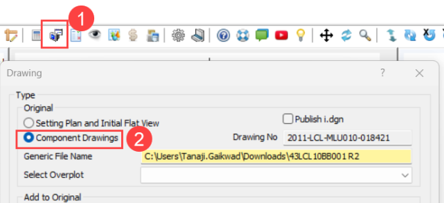

Question:
How to generate detail / component drawings?
Answer:
To generate component drawings, please select the Component Drawing option in the Drawing window. Refer to the image below for guidance.

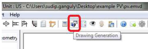

6. With the file open, click on the drawing generation icon:
7. Click OK in the Drawing window that pops up.
8. Once the drawing generation activity is completed by the program,
Check the folder containing the file, the created 3D AutoCAD file should be in the folder.
