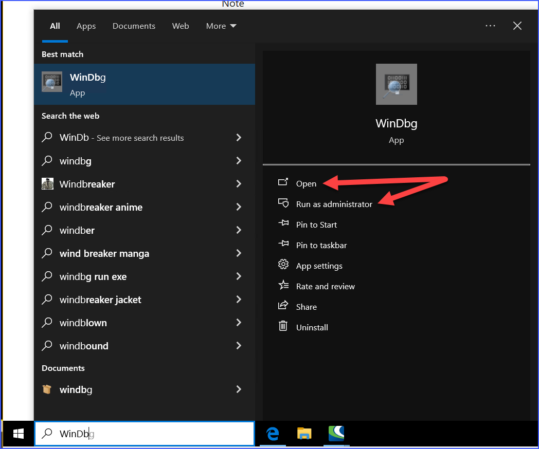

      2) Open WinDBG application -
Go to Start button, type in "WinDbg" and press "Open" or "Run as Admin" option.

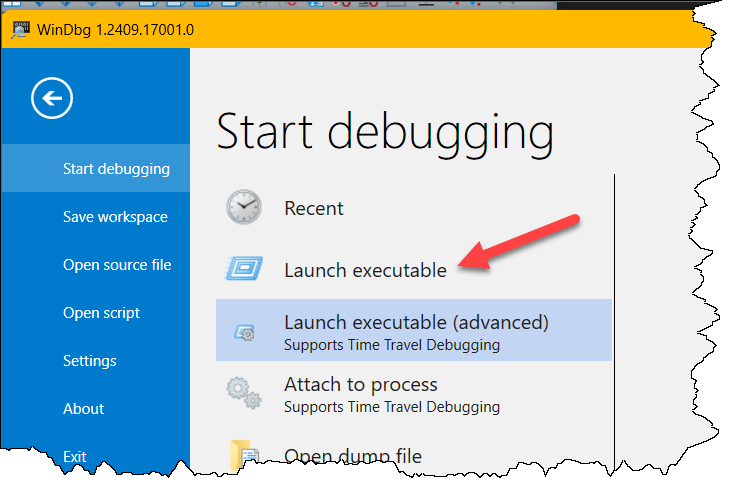

      3) After Starting the application, Select "File > Open Executable"
      4) Browse for executable file from folder where program was installed and press Open button.
AutoPIPE; browse for "autopipe.exe"
Typically: C:\Program Files\Bentley\AutoPIPE 20xx\

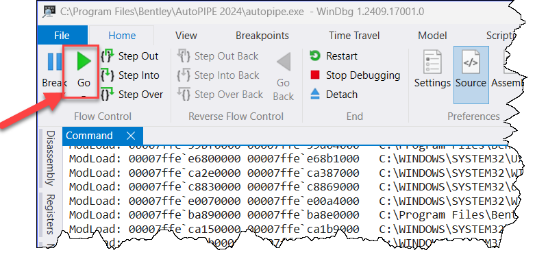

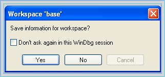

      5) if message 'Save Information...' appears, press No button.
      6) When ready press "GO" button.

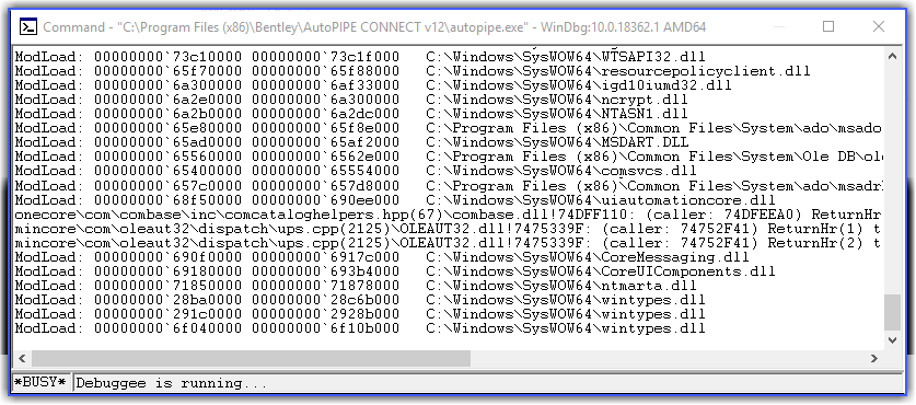

      7) In just a moment, AutoPIPE should start automatically, use the application as usual until to error occurs or that the program crashes. Now, go to next step!
Note: in the background WINDBUG application is recording hundreds of lines of information related to exactly what is happening on your computer.

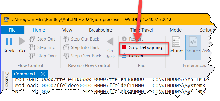

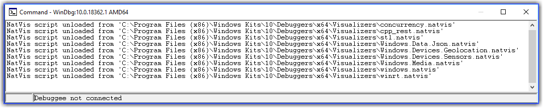

      9) Finally, press the "Stop Debugging" button and close the application
Note: The following is shown in WinDBG log after using Stop debugging command. and is not apart of the log file needed by Bentley development.
