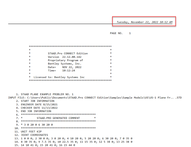

Changing the date stamp in the printed Output file
 Product(s):STAAD.Pro
 Version(s):All
 Environment: N/A
 Area: Post processing
 Subarea:
 Original Author:Modestas Turulis,
Bentley Technical Support Group

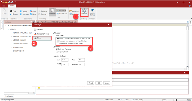

How can we change the date which is printed in the header of the printed Output file?
You can control the time step in the printed Output file by going to Settings -> Print in the Output File Viewer. One of the three options can be selected of the Date/Time in Header of the Output file:
