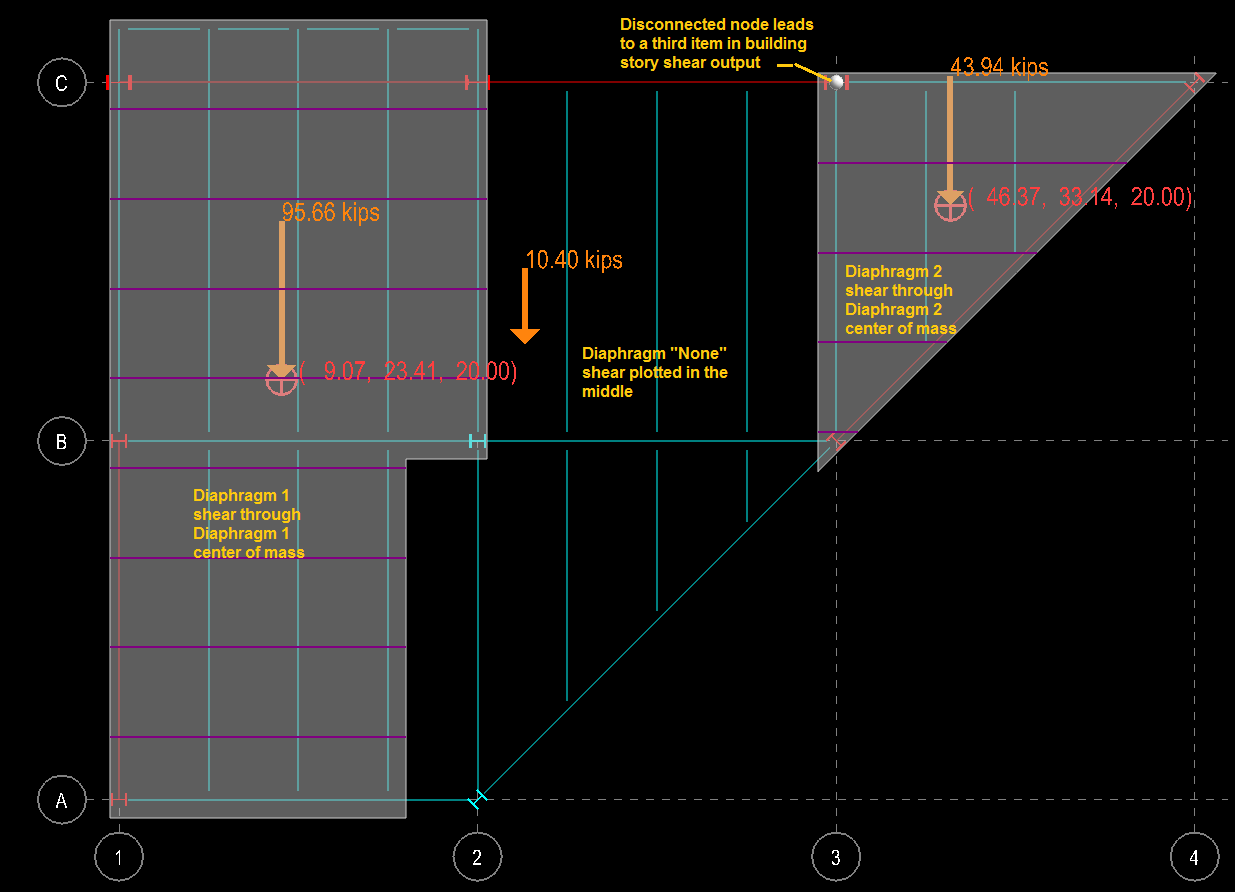

Diaphragm Story Shear is calculated based on the subset of the story nodes and members within a specific diaphragm boundary. The total shear at nodes that are disconnected from the diaphragm or outside a diaphragm boundary are reported as Diaphragm # "None" at each level in the Building Story Shear Report. For a chevron braced condition where the braces are all disconnected from the diaphragm, this diaphragm "None" shear can be almost all of the shear in the structure. (Note, it is the diaphragm shear and not the total story shear used in the ASCE 7 Stability Coefficients report)

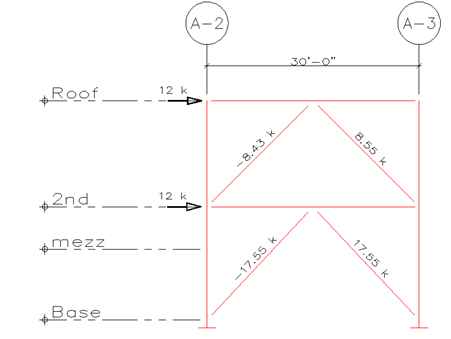

Multi-story Braces

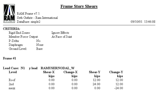

When a brace is modeled such that it bypasses a level, it will not have any nodes at that intermediate level. Thus, when the program sums all of the loads for that level, the forces within those braces are not accounted for. The net force given in the report is therefore low, and the change in shear may appear as negative.
As you can see, the story shear is correctly reported for the Roof level and the 2nd level where the braces have nodes. At the mezz. Level, however, the braces have no nodes, so the forces within those braces are not included. The only shear in the frame in that case is the shear in the columns, which in this case is null. So the total shear that the program recognizes at the mezzanine level is 0, which is a loss of 24k from the level above.
Obviously, this information is not helpful. In those cases, it is recommended that you strike out the intermediate levels from the frame story shear report altogether, and recalculate the "change in shear" value manually.

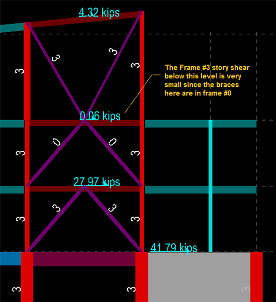

A common cause for unexpected frame story shear results is inconsistent frame numbering. For example, if you delete and remodel the braces in the modeler, the new braces are automatically assigned Frame #0. If you do this at one level but not another level and forget to reassign the frame numbers to the new braces then the frame story shear will be confusing.
Generally speaking the best policy is to assign the frame columns and braces of any interconnected frame a single number. Corner or L shaped frame may be an exception to this rule as described on the RAMSS Pseudo Flexible Diaphragms FAQ.

To show the building story shear on screen use Process - Results - Building Story Shears. Display of building story shear - diaphragm shear is through the diaphragm center of mass. Where there is no diaphragm, or for shear associated with diaphragm "None", the plot is through the a somewhat arbitrary location near the geometric center of all framing.

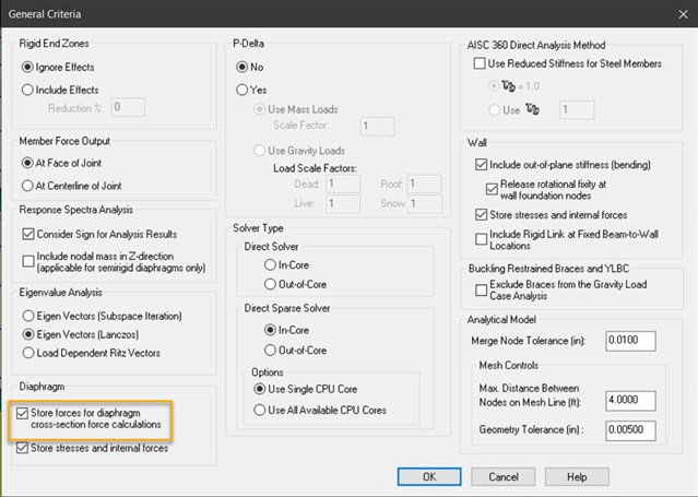

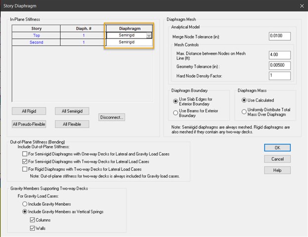

Why can't I access the Diaphragm Section Forces Report?
The diaphragm section forces report in Ram Frame - Analysis mode is used to report the resultant forces acting on a slice through the diaphragm. lt is only for use with semi-rigid diaphragms and only when the option to save diaphragm forces is turned on under criteria - general.
