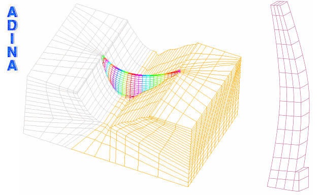

The ADINA model of the dam is shown in Figure 2. Seismic shaking was applied in the ADINA model as acceleration loading. The seismic load was applied in combination with the dam’s self-weight and the reservoir water pressure on the upstream side of the dam. The hydrodynamic effects where included as well in the dynamic analysis.
Figure 2  Finite element model of the dam. (Left) The dam and the rock base.
(Right) Detail of a central monolith, no. 11, of the dam
