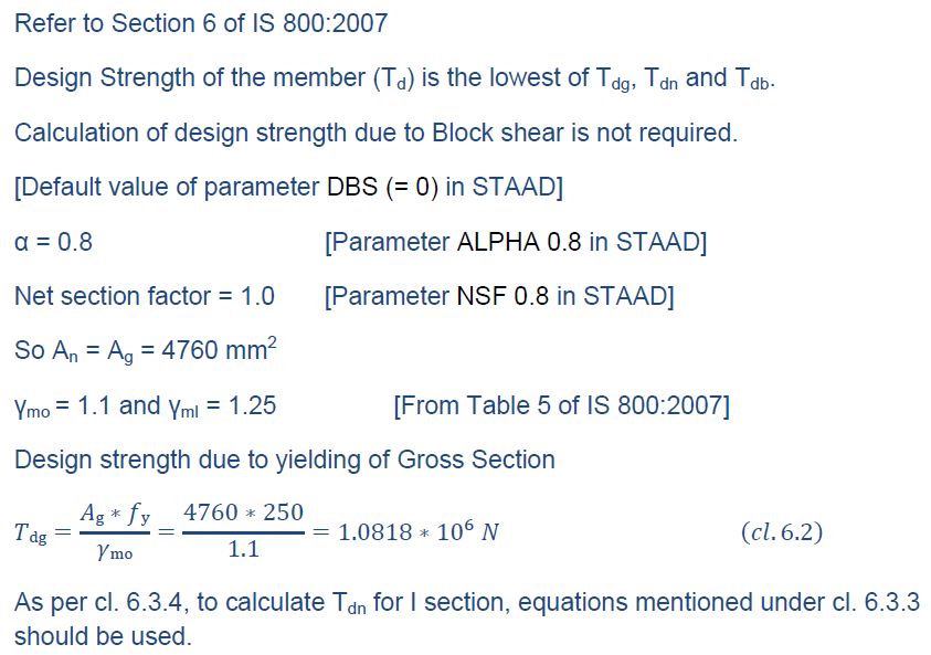

Tension Capacity Check

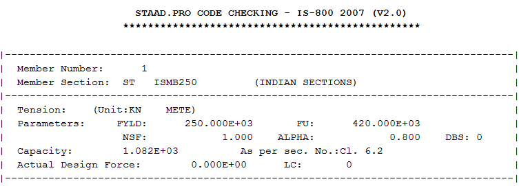

STAAD.Pro Design Output
