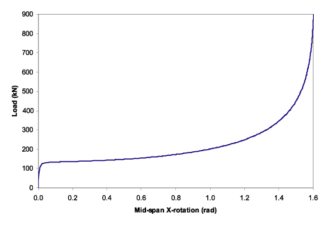

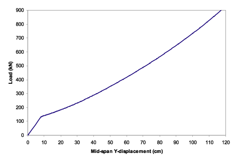

We model the complete beam using 20 Hermitian beam elements that include warping degrees of freedom. The boundary conditions are that the rotation about the x axis is fixed at both supports while the other rotations are free and all the displacements at both supports are fixed except the displacement in the x direction at the right support. The warping displacements are free at both ends. In both analyses using different cross-sections, we consider two loading conditions: the concentrated load is once applied in the upward direction and once in the downward direction. In both cases, the load is applied at the centroid of the cross-section. At first sight, it may appear that the direction of loading will not change the absolute value of the buckling load, whichever beam cross-section is used, but there is a “twist”.
Figures 3 to 5 below show the calculated response when considering the doubly-symmetric I-beam section of Figure 2a. The beam bends initially only in the x-y plane but at a load level of P = 135 kN buckles out of that plane and twists about the x-axis. As expected, the response of the beam for upward loading is the same as for downward loading, apart from a sign change of the displacements.
Figure 3  Load vs. downward displacement of doubly-symmetric I-beam

Figure 5  Load vs. x-rotation of doubly-symmetric I-beam
