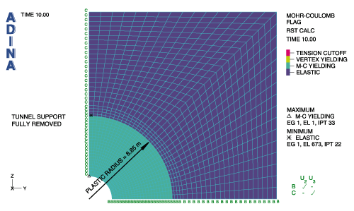

The second problem considers a tunnel in which the initial support of the tunnel roof is gradually removed (see Fig. 3 below). The objective is to establish the displacement of the tunnel roof as the support is being removed. The support is modeled as a radial pressure.
Figure 3 Schematic of second problem
The results obtained show that plastification starts occurring between 50% and 55% of pressure removal and that the final plastic radius (i.e., when there is no pressure in the tunnel) is 8.85 m (see Fig. 4 below). Finally, Fig. 5 shows the evolution of the radial displacement of the tunnel as it is unloaded.
Figure 4 Results of second problem: band plot of Mohr-Coulomb flag
in Region A of Fig. 3
