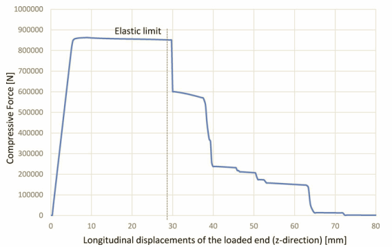

A preliminary quasi-static collapse analysis is first performed to identify the post-buckling response of the mast. The computation consists of a linearized buckling mode step and a static step. In the linearized buckling mode step ADINA extracts the buckling shapes of the masts (the eigenmodes). In the static step an assumed initial imperfection is applied based on the buckling shapes. The load-displacement curve then calculated indicates the progressive collapse behavior, as shown in Figure 3. The progressive collapse is clearly a global buckling phenomenon, as can be seen in the post-buckling shape of the buckled mast (Figure 4).
Figure 3  Progressive collapse analysis: compressive force vs. longitudinal displacements in the z-direction, showing pre- and post-buckling stages up to collapse
Figure 4  Mast collapse due to axial static compressive loading, showing band plot of von Mises effective stress
