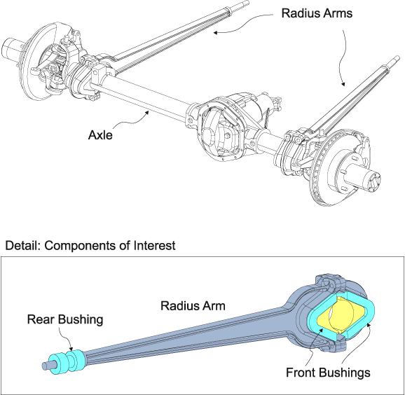

The following example demonstrates how a 3D solid finite element model of a light truck suspension component, complete with connecting bushings, can be replaced using 3 connector elements which provide the equivalent structural response at a small fraction of the computational cost.
Figure 1 illustrates the components under consideration in relation to the vehicle’s front axle. The inset in Figure 1 details these components.
Figure 1  Suspension components under consideration, with detailed inset. The inset shows the 3D solid model of the radius arm (grey) and its attached bushings (blue). The radius arm is steel and linearly elastic. The bushings are rubber (large strain hyperelasticity, incompressible).
