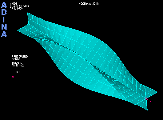

Now, let us consider a doubly symmetric section, a cruciform, as depicted in Figure 2. This problem shows the importance of considering the axial-torsional coupling. All the displacements, rotations and warping DOFs at both ends of the beam are fixed with the exception of the x-displacement DOF where the axial force is applied. Linearized buckling analysis of this beam is carried out using both the warping beam and MITC4 shell models. The animations below show the first three buckling modes of this structure using the MITC4 shell element discretization. Note that in these buckling modes the centerline of the cross-section remains a straight line (it doesn’t bend) while the cross-section twists about the centerline. Table 2 compares the buckling loads calulated using the warping beam model with the closed form solution [1,2].

1st mode
2nd mode
3rd mode

For doubly symmetric cross-sections, this mode of buckling — the axial-torsional buckling, can be dominant when beams are short. However, Euler buckling is dominant when beams are long.

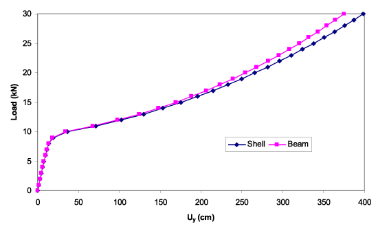

In the next example we consider once again the channel section (see Figure 4), but now in large deformation analysis. A concentrated load is applied at the center of gravity of the section, once in the y-direction, and once in the z-direction. One end of the beam is clamped and all the DOFs including warping are fixed at the clamped end. Figures 5 and 6 show the load-displacement response of the structure using warping beam and MITC4 shell models when the load is applied in the y-direction. An excellent agreement is achieved between the two solutions. The animation at the very top shows the deformation of the beam when the load is applied in the y-direction. The animation just below it shows the response when the load is applied in the z-direction. As can be seen, when the load is applied in the y-direction, initially the beam moves in the y-direction without much lateral movement and only little twisting, but beyond a critical value, the section starts to twist significantly and the lateral movement of the beam becomes pronounced. However, when the load is applied in the z-direction, the beam only bends in the x-z plane without twisting.

Figure 5  Load vs. y-displacement at the tip of the channel section (when load is applied in the y-direction)
Figure 6  Load vs. z-displacement at the tip of the channel section (when load is applied in the y-direction)
This example highlights the importance of considering the effect of eccentricity of the shear center with respect to the center of gravity in the kinematic formulation of the beam. It also shows the importance of bending-torsion-warping coupling and the so-called Wagner effect in the response of thin-walled open section beams, when subjected to large twists.

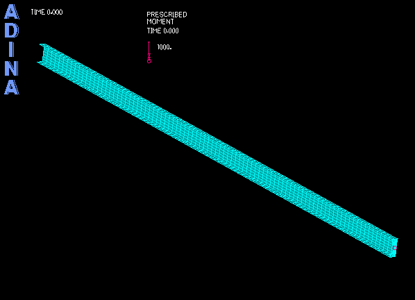

For the last example, we study the response of the same channel section beam, but this time the beam is subjected to a torque at its free end, which is applied at its center of gravity (see Figure 7).
Figure 7  Large deformation analysis of a channel section subjected to twist
All displacements, rotations and the warping DOFs at the clamped end of the beam are restrained. At first glance, engineering intuition might lead us to believe that the section only twists about its centerline and the beam will not bend. However, as can be seen in the animation below, due to the coupling between bending and torsion for this mono-symmetric cross-section, the twisting will cause this beam to initially displace only in the y-direction, and for larger twists, also in the z-direction.
