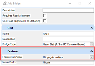

All these decorations are controlled by the feature definition Bridge_decorations, which can be selected when the user adds a new bridge or after the bridge was created.

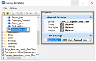

- create a new level;
- create a new text style or chose from the library, if the decoration needs a text style;
- create an element template with the corresponding level and text style;
- create a feature symbology using the element template previously created;
- assign the feature symbology to the corresponding field in Bridge_decorations feature definition.

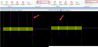

By default, all the text decorations are using text styles that are annotative so the user will need to use a drawing scale bigger than 1:1 to see the decorations in the 3D model. With this implementation, the user can turn off the decorations by using the options Show/Hide Decorations from the project tree or by turning on/off the levels that he specified in the element templates. For instance, one can have a level assigned to the Supportline line and another level assigned to the Supportline text, thus he can control what he wants to see in the model, especially when creating framing plans.

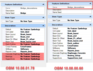

When the user will open an older file, he will find differences between the feature definitions saved in the file i.e. the ones created in the older version of OBM and the ones that are now saved in the libraries. For instance, if we look at the Bridge_decorations feature definition we will observe that now we have extra fields with feature symbologies that need to be completed.

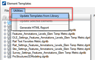

The simplest way to update the feature is:
- open the level manager, select your working file, right-click and select “Update Levels”; this will update the level definition from the library;
- open the element templates dialog and go to Utilities --> Update templates from Library; this will update the element templates with the latest changes found in the libraries
- based on the feature symbologies from the libraries, manually create the missing feature symbologies that are needed for the Bridge_decorations feature definition.

1. The user will need to always attach a feature definition (like Bridge_decorations) to his bridge. If he fails in doing so, some default values will be attached to the decorations.
