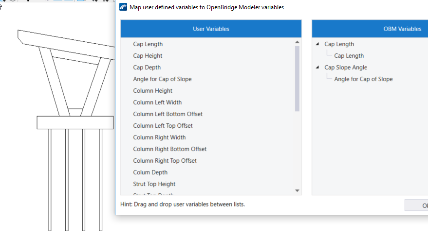

5. Variable Mapping command: The last step in preparing the functional component for use in OBM is to map the user defined variables to the OBM specific variables. At this time two variables are exposed in OBM, the Cap Length and the Cap Slope (as an angle). By dragging and dropping the user defined variables over to the appropriate OBM variables we will allow the functional component after it is placed in the OBM file to automatically react to the changes in the bridge.

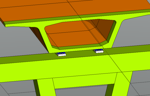

An example of functional component after definition of all constraints and parameters.
