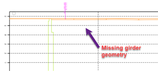

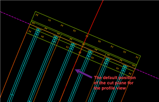

By default, the cut for the profile view is made using a vertical plane that passes through the alignment. In some cases, as in the image below, there is no geometry to show (cut) in the profile view because the solids (in this case the girders) are not positioned in the same plane as the alignment.

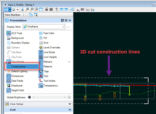

2. After the profile cut view was created using the default options, select the 3d cut construction lines and either open their properties using the properties window or open the properties from the pop-up menu.
If the construction lines are not visible, make sure to turn them ON from the View Attributes window.

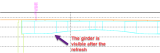

3. Under the Clip Volume category, you will find an option to specify a horizontal offset for the profile cut. A positive value moves the cut to the right and a negative value moves the cut to the left. Based on your needs insert a desirable value and then accept the input with Enter.
4. In order to update the initial profile cut to the new position, refresh the cut.
After the refresh, all of your initial cuts will be updated to take into account the horizontal offset. At this point, there is no option to specify a view depth for the profile cut.
