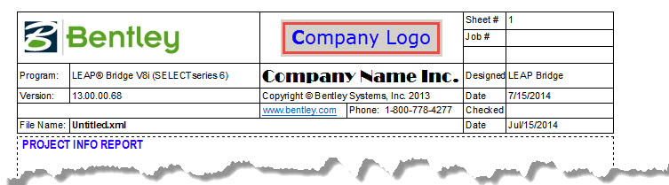

One can add a Company Logo and Company Name to your reports generated from LEAP Bridge Enterprise:.

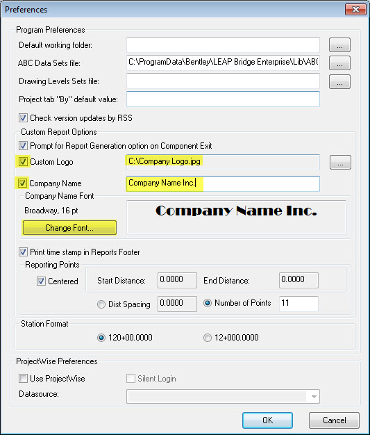

- To begin, save your company logo in the form of a JPG or a BMP file to a location on your computer.
- When you have LEAP Bridge Enterprise (LBE) open, click on Options > Preferences:
- Toggle ON Custom Logo and click on the File Selection button to select the JPG/BMP you saved in step 1.
- Toggle ON Company Name and key in your company name.
- To change the Font, style and size click on Change Font
Now when the report is printed your company logo and company name will also be displayed on each page:
