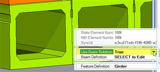

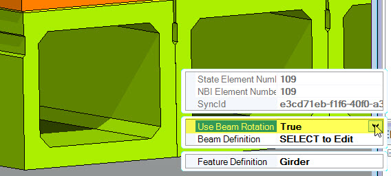

Figure 1: Beam Definition rules/properties allows the user to specify if the "Use Beam Rotation" option is True or False.

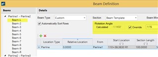

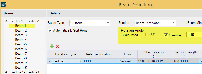

Figure 2: Beam specific Rotation Angle displayed on Beam Definition dialog, with Override option activated.
