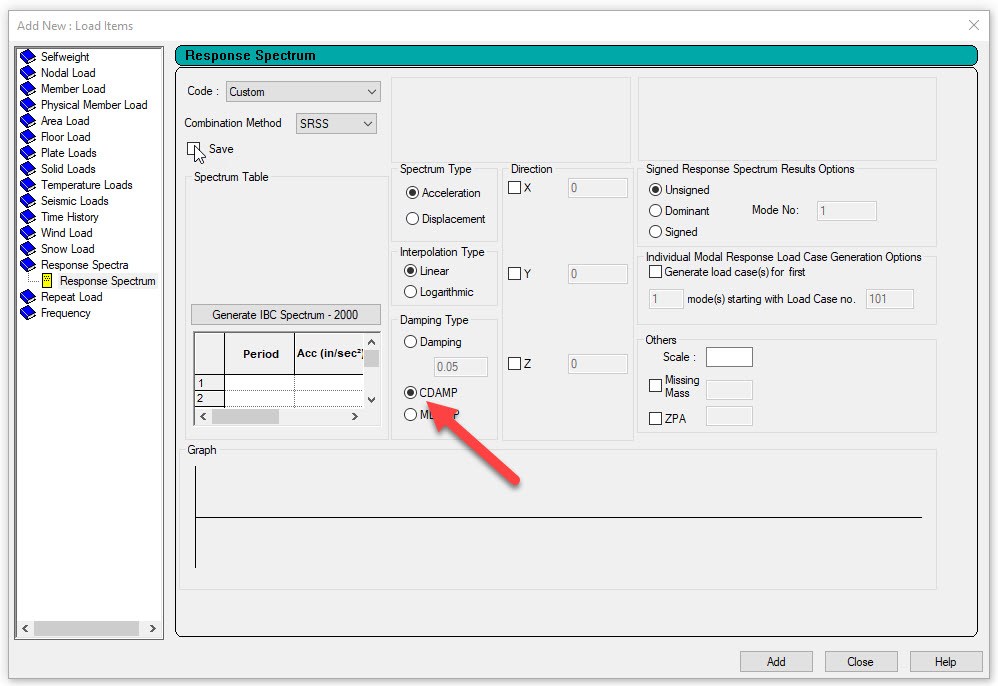

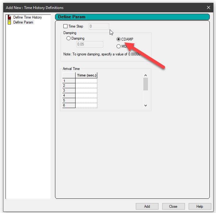

1.  Enter the CDAMP command - If CDAMP is specified then "composite damping" is used, as determined by the values for material damping (and spring damping, if defined).  This means the damping of structural entities (members, plates, solids) is considered according to their material assignment, as well as the damping of spring supports.
For time history loading CDAMP is included in the time history definition:
For response spectrum loads CDAMP is specified in the load itself:

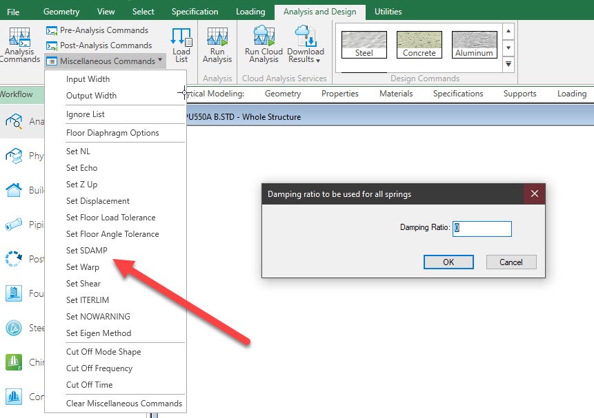

2.  Enter the SDAMP or SPRING DAMPING command - the actual damping value for the springs can be defined one of two ways.
The Set SDAMP command can be specified by going to the Miscellaneous Commands menu under the Analysis and Design tab:
The value entered will be applied to all spring supports in the model.

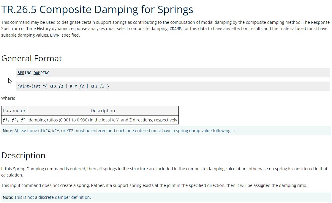

The other way is to enter the SPRING DAMPING command into the STAAD Editor, as described in section TR.26.5 of the STAAD.pro Help documentation:
This command allows you a bit more control than SET SDAMP because you can specify the specific node to be considered and also enter separate damping values for the X, Y, and Z directions.
