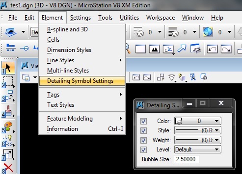

How to set the default symbology settings?
 Product(s):MICROSTATION
 Version(s):08.09.00.92
 Environment: N\A
 Area: Detailing Symbols
 Subarea: General
Where is the Drafting Tools Properties dialog and how to set the default symbology settings?
The Drafting Tool properties are located under the Element > Detailing Symbol Settings menu. Once the settings are set here, these will be the default settings for any of the Drafting Tools when used.
