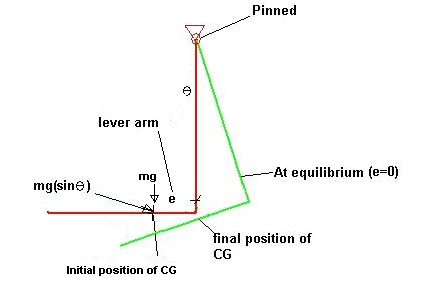

Consider the example shown below.
The complete arrangement is being suspended from a single top support. Due to eccentricity of the center
of gravity with respect to the support, the initial loading condition induces an initial rigid body rotation.
If one wishes to avoid using stabilizing rotational springs, the structure has to be analyzed in the equilibrium position.
For this, the eccentricity needs to be determined (the horizontal distance of CG from the X and Z coordinates of the point of suspension). The center of gravity of loading can be found in the output file with the help of the PRINT CG command .
From this data, Θ be computed . Next, rotate the structure by that angle “Θ” , so that the load is aligned with a line passing through the support coordinate. Thus, you are now analyzing the arrangement at the equilibrium position.
