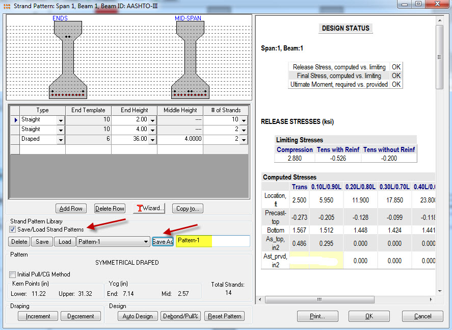

Once the Beam Girder is designed and Strand Pattern is set and if the user wants to check a different strand pattern then the user can save the Original Strand pattern by checking the option Save/Load Strand patterns under Strand Pattern Library.
User can give a name to the Strand Pattern , For ex: Pattern-1.
Same way user can save multiple Patterns and create their own library.
The user can click on LOAD button and can populate the required Strand Pattern.
