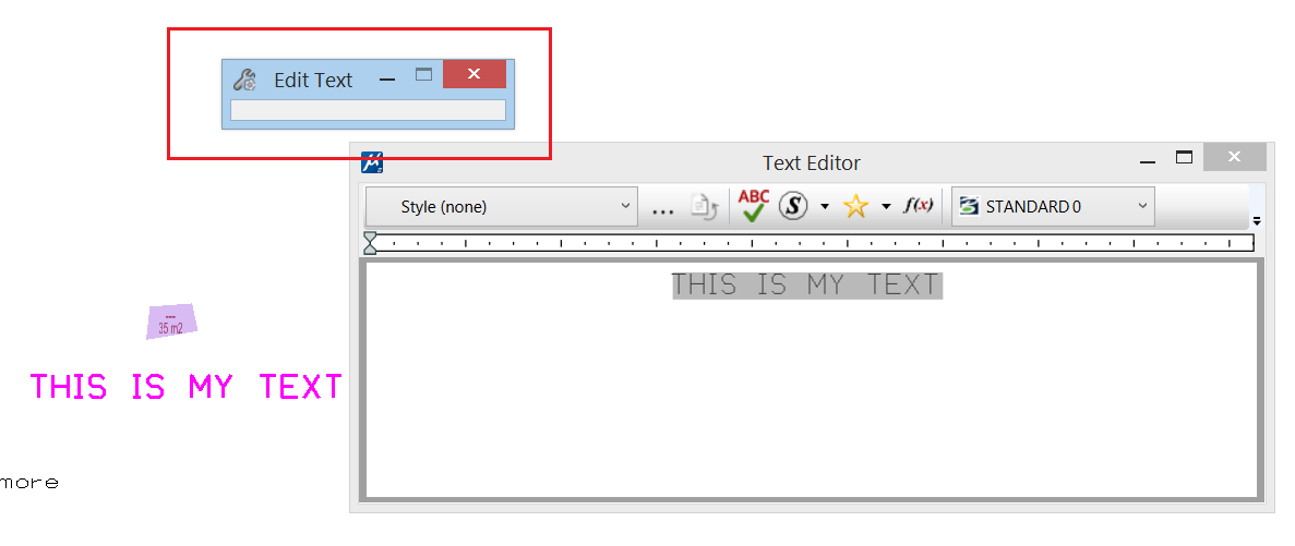

Where are the Edit Text tools in MicroStation CONNECT Edition? The Edit Text dialog has no tools which used to be there in previous versions.

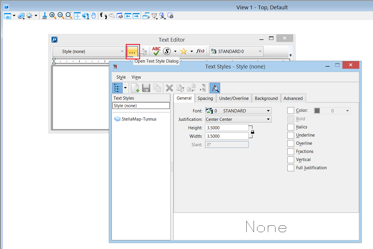

1. In the 'Text Editor' click the 'Open Text Style Dialog' icon (three little dots) and the 'Text Style Dialog' opens and you can change settings:

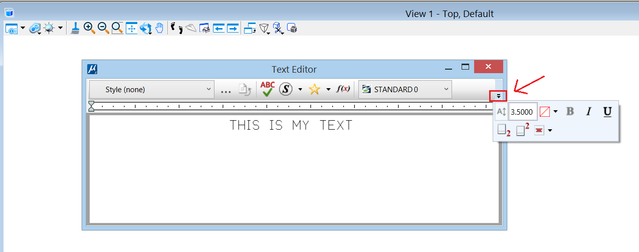

2. In the 'Text Editor' click the little arrow on the right side of toolbar and the tools pop up:

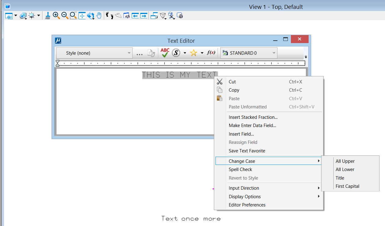

3. In the 'Text Editor' select the text and then right click on the dialog > pop-up menu appears and you can make modifications:
