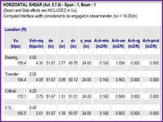

QUESTION: Nomenclature -- Horizontal Shear?
ANSWER:
Avh-rg = Area of Required Horizontal Shear reinforcement for Rough Finish.
Avh-Min = Area of Minimum Horizontal reinforcement.
Avh-Prvd = Area of Provided Horz. reinforcement.
Avh-sm = Area of Required Horizontal Shear reinforcement for Smooth Finish.
Vnh = Horizontal Factored Shear force per unit length of the beam.
Vu = factored shear force at specified section due to Super imposed load.
