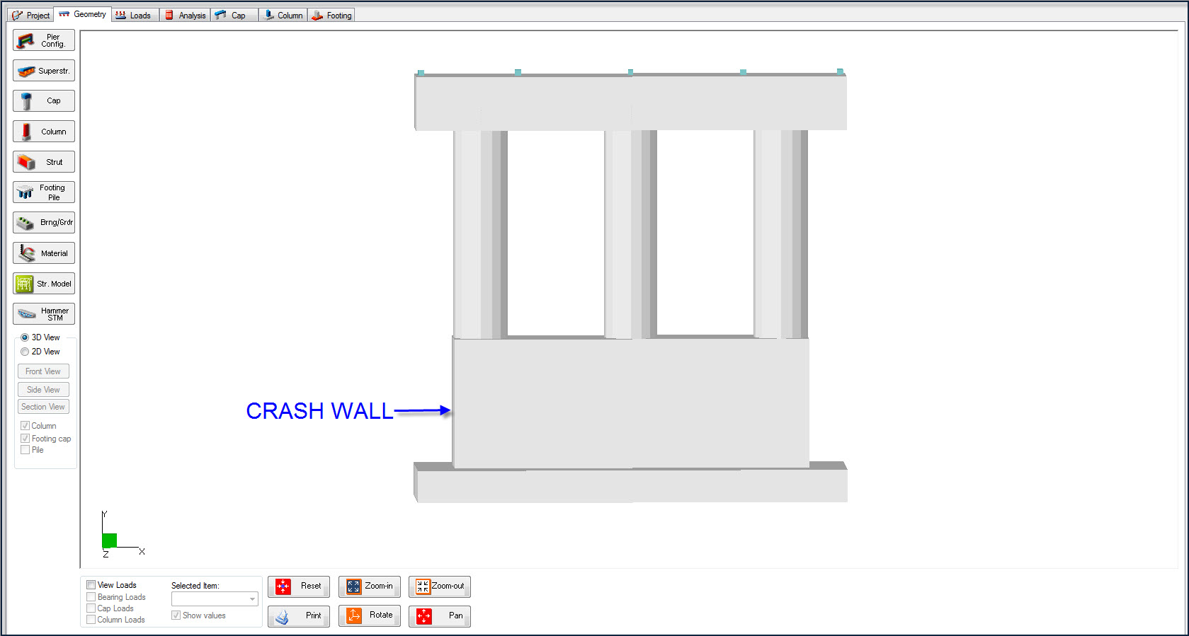

QUESTION: Is it possible to model a crash wall in RC pier ?
ANSWER:

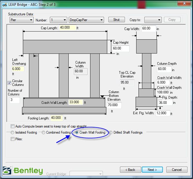

Currently in V14 it is not possible to model a crash wall in RCpier but the user can model a strut as a crash wall and analyze the structure. This is the only workaround solution available in the program
In V15 Crash wall Footing option can be checked in ABC wizard where in the user can input the Crash wall Width , Depth .
Please see the attached screenshot for more information.
