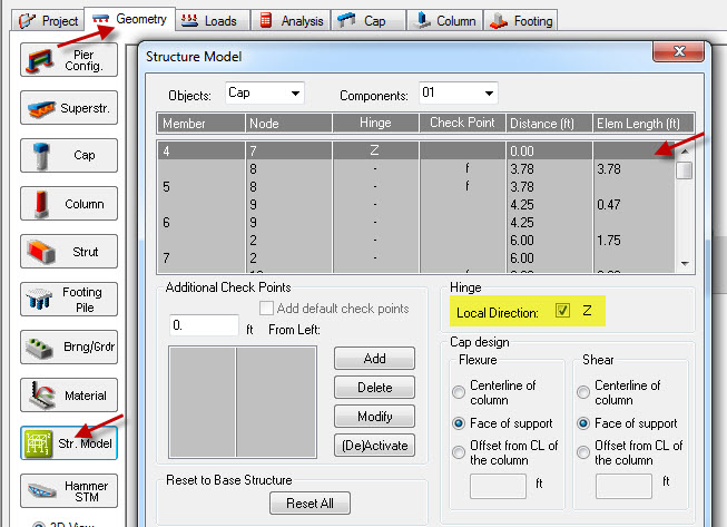

QUESTION: How to assign Hinge in RC pier ?
ANSWER:
User needs to go to Geometry TAB and then click on Structure Model and in the new window under Hinge heading user needs to check the box which says " Local Direction  Z ".
