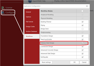

How to perform a steel design using Chinese design code?
To design steel members per the Chinese GB 50017-2017 code, first Configure the workflow as shown in attached image.
To use the Chinese steel design workflow, the steel sections must be from the steel section table or from a user-provided table.  For specification of member properties, either the steel section library available in STAAD.Pro or user-provided table sections may be used.
