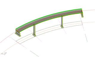

Using Bridge Wizard that allows to quickly create a complete bridge model by entering just a few inputs.
  1. Bridge name.
  2. Alignment pick interactively from *.dgn file or use one default alignment.
  3. Bridge Type.
  4. Deck Template under Utilities > Libraries.
  5. Span lengths as L1 L2 L3 or L1 3@L2.
  6. Support Skew Angles.
  7. Abutment Template under Utilities > Libraries.
  8. Pier Template under Utilities > Libraries.
  9. Left and Right Barrier Template.

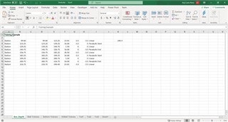

Introducing deck geometry variables in Variable Constraint.
By Copy/Paste from Excel Spreadsheet file.

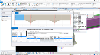

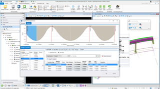

Defining Tendon points with Tagging Tool and after establishing the variable constraint name.
Introducing tendon geometry in Variable Constraint.

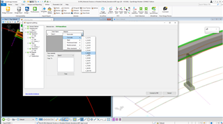

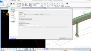

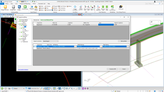

Sending the model to RM Bridge:
  1. Standard Code and Material Group;

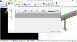

  2. Segment's subdivision;
  3. Support restraint conditions;
  4. RM Materials.
