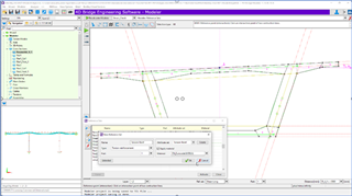

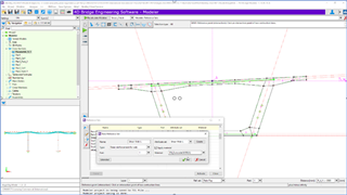

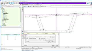

RM > Modeler > Cross Section > Reinforcement Types
 Longitudinal reinforcement for cracking, bending …..
Shear reinforcement for web on shear calculation.
Shear longitudinal reinforcement for shear calculation.
Torsion reinforcement for torsion longitudinal and transversal calculation.

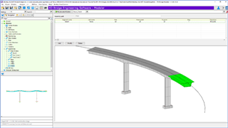

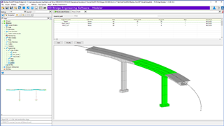

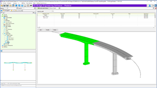

RM > Modeler > Assemblies
Group elements for the different construction stages:
STG01
STG02
STG03

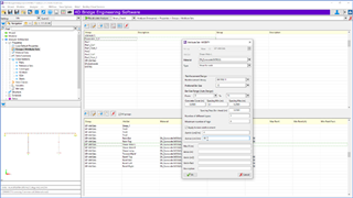

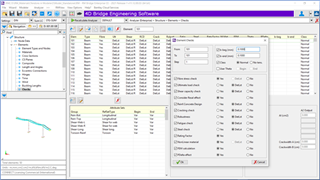

RM > Analyzer > Groups / Attribute Sets
Preparing Reinforcements for drawing layout:
  1. Reinforcement library.
  2. Preferred bar size.
  3. Range of bars.
  4. Concrete cover.
  5. Spacing Min.
  6. Spacing Max.
  7. Spacing step.
  8. Number of layers.
  9. Number of legs.
  10. Apply torsion reinforcement.
RM > Analyzer > Structure > Elements > Checks
User can apply the duct width reduction for shear check calculation.
Assign elements for design code check.
Apply one fix reinforcement area value or require the program to calculate it.
And ask for the detailed reports with all the calculations performed by RM Bridge.
