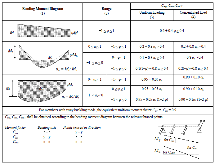

(Page 57, Table 14)
Substitute LLT/ry and hf/tf for KL/r and h/tf.
Not Applicable

(Page 58, Table 15, col 3, first row)
Substitute ‘Both flanges partially restrained’ for ‘Both flanges fully restrained’.
Not Applicable

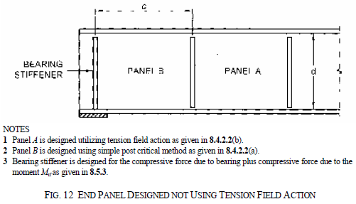

35
(Page 62, Fig. 12)
Substitute the following for the existing figure:
Not Applicable
