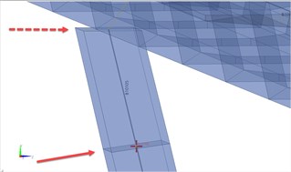

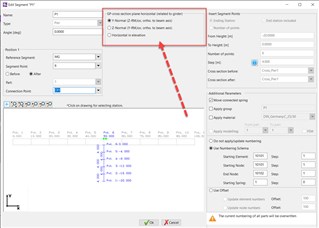

For modeling an inclined pylon in RM Bridge the user can either have the cross-section of the element in-plane, with the usual option of the cross-section plane horizontal, or perpendicular to the element axis.
CSPlane   CSPl

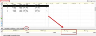

These inclined element cross-sections can be achieved by modifying the local coordinate system, the CS can be rotated about the vertical direction by using a value different from the Default 0 for the DA angle of the Cross Sections.
SegOff   EditSPOffset
Note these options allow also for adjusting the vertical stretching of the cross-section with the selection of the toggle Adjust vertical stretching.
