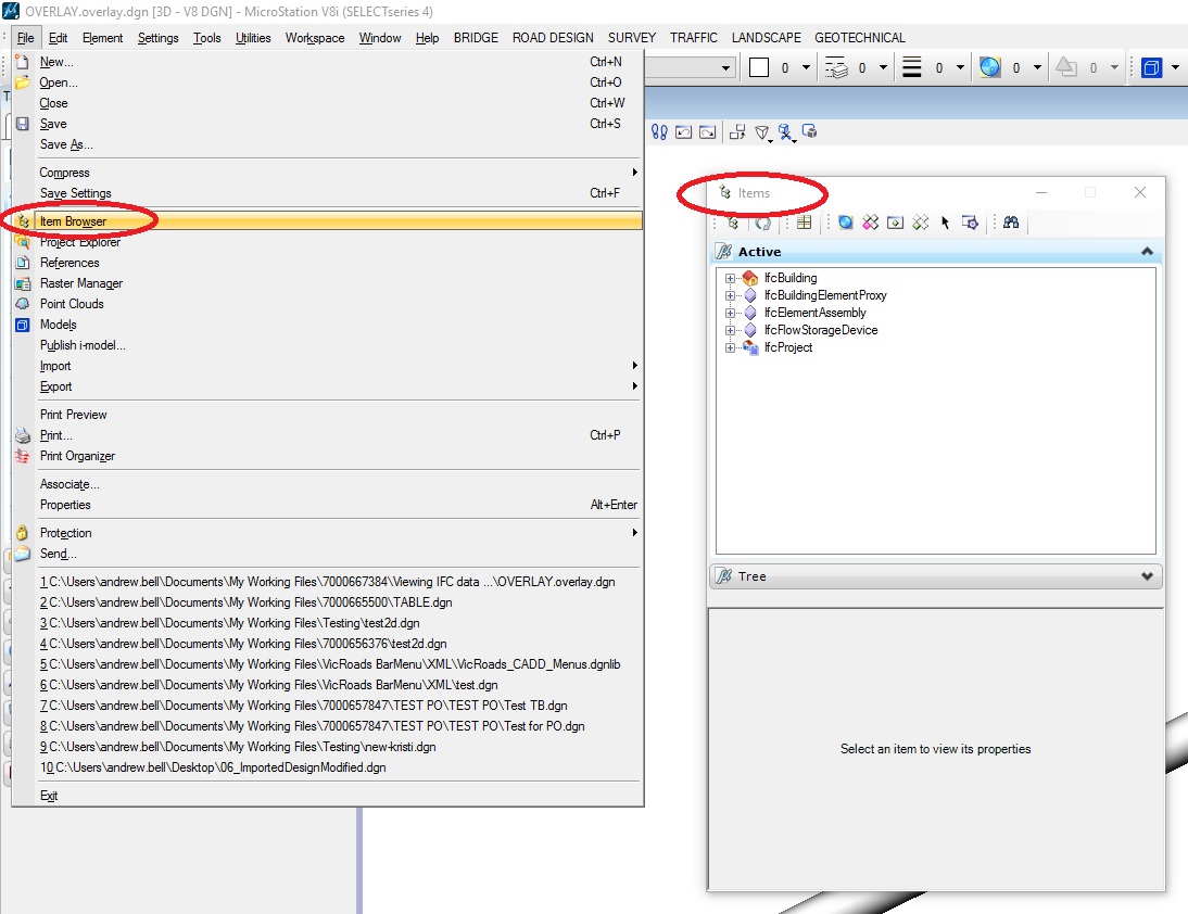

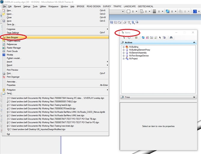

Previously, in MicroStation V8i, to view of list of non-graphical items contained within a DGN or attached as a reference, you could open the Item Browser to display these items. Where is this located in MicroStation CONNECT Edition?

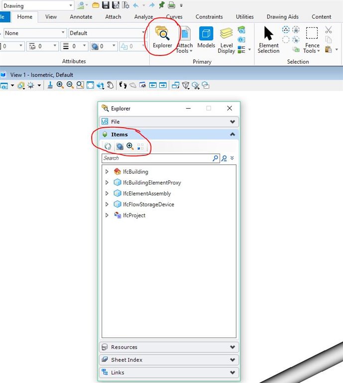

In MicroStation CONNECT Edition these Item Types can be viewed in the Explorer tool available in the > Home > Primary ribbon.
