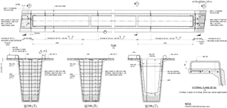

Figure 1: Typical Australia Super Tee Beam Drawing shows both interior diaphragms and end solid blocks.

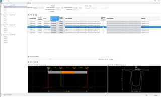

NEW: OpenBridge Modeler now also includes in the default Beams Template Library all of the definitions for the closed standard Super-Tee sections from the AS 5100.5 Australian Bridge Design Standards. Therefore, now it's just a matter of directly adding the necessary interior diaphragms and end solid blocks, as shown in the images below.
Super   S-T

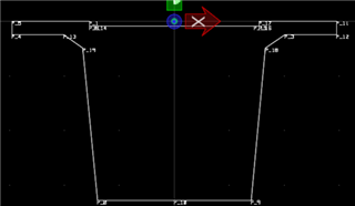

1. OBM already includes in the default Beams Template Library all of the standard Super-Tee sections from the AS 5100.5 Australian Bridge Design Standards.

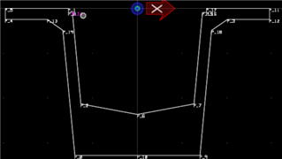

2. Make a copy of the standard template and edit it to create a cross-section resembling the filled-in section for the appropriate beam cross-section being used.

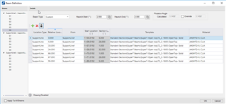

3. Now place the deck and beams in OBM in a typical manner in OBM. In the Place Beams command, you can create section variations to model the solid portions at end blocks and diaphragm locations.

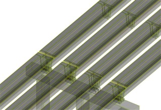

4. The resulting beams can be seen in the images below
Isometric View (Solid - Model)

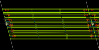

Top View (Wire Frame):
